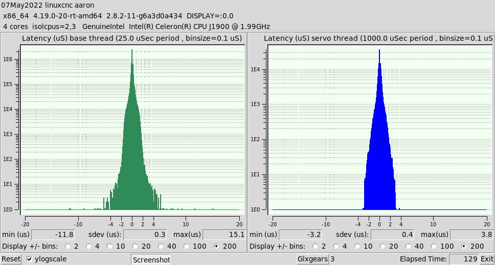

3 axis mill with a 5i25 and 7i77 on a ASRock Q1900B.
This machine ran for years on Wheezy and 2.7 RTAI, but I wanted to modernize it so I installed a 23" touchscreen and updated to 2.8.2, Debian 10 PREEMPT-RT and LinuxCNC.
After the upgrade I get the error Unexpected Realtime Delay on task 0 with period 200000 and DoLt not cleared from previous servo thread. Servo thread rate probably too fast.
If I adjust the servo rate to 250000 I do not get this issue. I get a following error when trying to home the machine if I keep the 200000 rate and ignore the errors or if I use the 250000 servo period.
Here is a picture of the latency histogram after running for ~30 minutes with youtube and 3 x GLXgears. Latency values were higher without isolcpus (which I never needed to use on the previous setup).
Shouldn't these latency values allow me to run an even faster servo period than 200000?
Attached is my .ini and .hal.
I have also tried 2.8.2 on RTAI and this resulted in slightly lower latency values, but still the same errors.

The latency test is pretty optimistic, as it does no actual I/O
If you want to get a realistic idea of where the time goes,
take a look at all the tmax values after running LinuxCNC
for a long time:
halcmd show param *.tmax
(these are in units of CPU clocks on X86)

09 May 2022 23:39 #242427
It is possible that the system is just running out of time. PCW has suggested a way to tell, though calculations will be needed.
Replied by andypugh on topic Unexpected Realtime Delay, but Good Latency Values
Yes, though you also need to consider how long it takes to perform all the calculations in the servo thread.Don't my latency values imply that I could easily run the 200000 servo period without errors?
