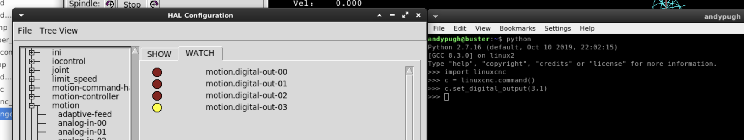

Hi all,
I have noticed an issue with digital output toggling.
I interface with LinuxCNC through the Python Interface.
What I have noticed is that if you toggle an output that has not yet been allocated within the HAL file, e.g. motion.digital-out-16, it will instead toggle motion.digital-out-00. ( c.set_digital_output(16, 1) )
If digital-out-00 is assigned to a physical output, i.e. hm2_5i25.0.7i76.0.0.output-xx, it will toggle that output, which could lead to unsafe conditions.
I haven't taken time to see if this issue is still evident in 2.8.2, but I have noticed it in LinuxCNC 2.8.0.
I have reserved motion.digital-out-00 as a "do not use" output to prevent accidental output toggling on the machine.

Does motion.digital-out-16 exist?
By default there are only 4 digital output pins unless you have enabled more.

Hi Rod,
It does but is not assigned. (It was an example in this case)
What I mean is there is no listing or signal assignment to the digital output.
If I try set an unassigned output via python "c.set_digital_output(x, 1)", it will instead set digital output 0 with the given state value.
The actual machine has num_dio=32
I'm setting up a newer iteration of said machine with num_dio=64 but I haven't gotten to final testing to see if the issue is still there in 2.8.2

You could raise an issue in github but bear in mind that expected use of these pins is to be set by gcode as stated here:Ref: linuxcnc.org/docs/devel/html/man/man9/mo...9.html#MOTION%20PINS[/i][/b]
motion.digital-out-[i]NN OUT BIT - These pins are controlled by the M62 through M65 words.

I use the python interface as I have my own automation controller that sits on top of linuxcnc so that I can sync two cnc together.
We use linuxcnc for a label print and place cnc for this particular project.
I'll raise the issue on Github, but it isn't an immediate concern as I have a work around with the reserved output-00.
Someone else might run into this same issue though and it threw me for a spin when I first encountered it.
