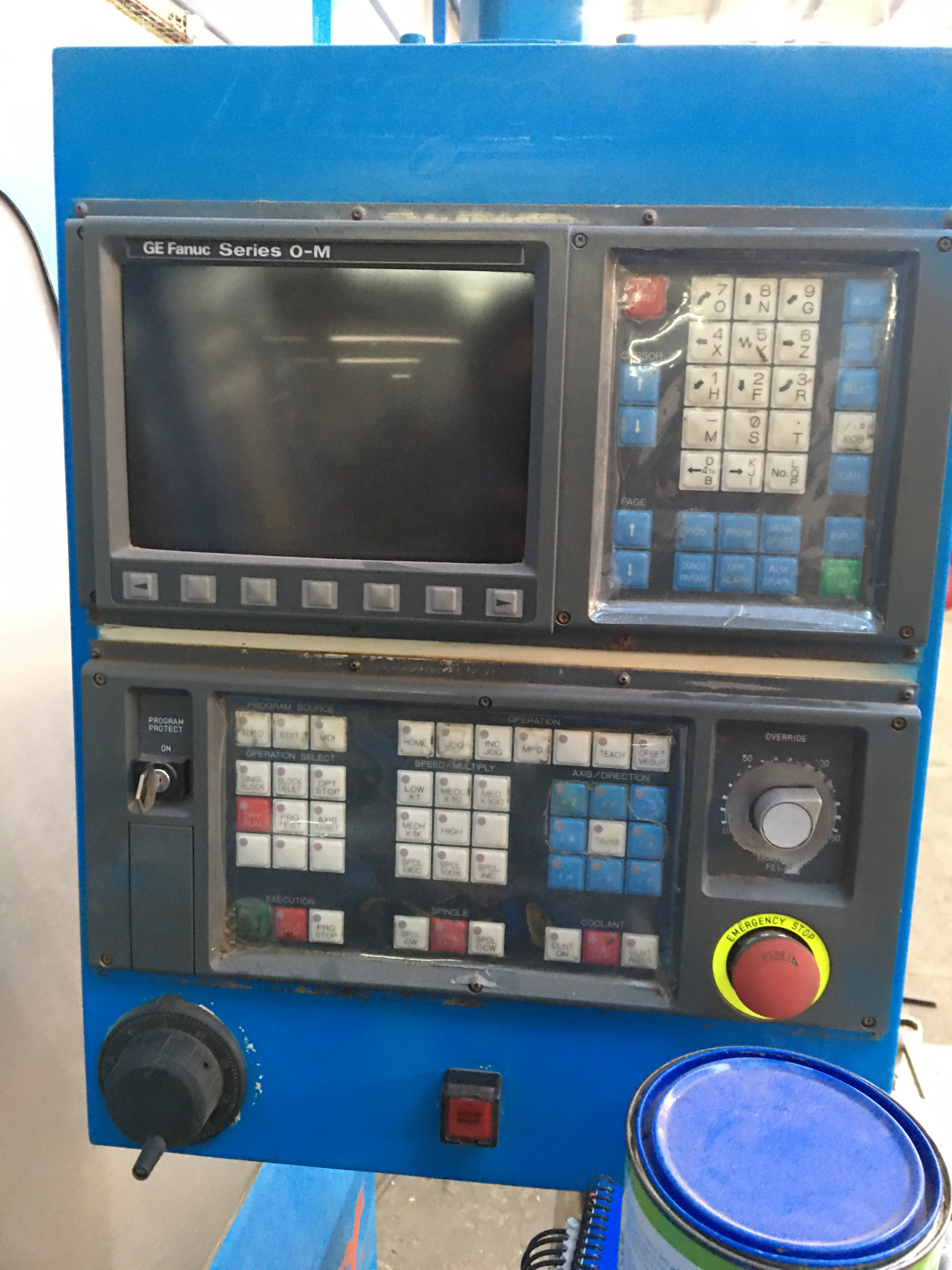

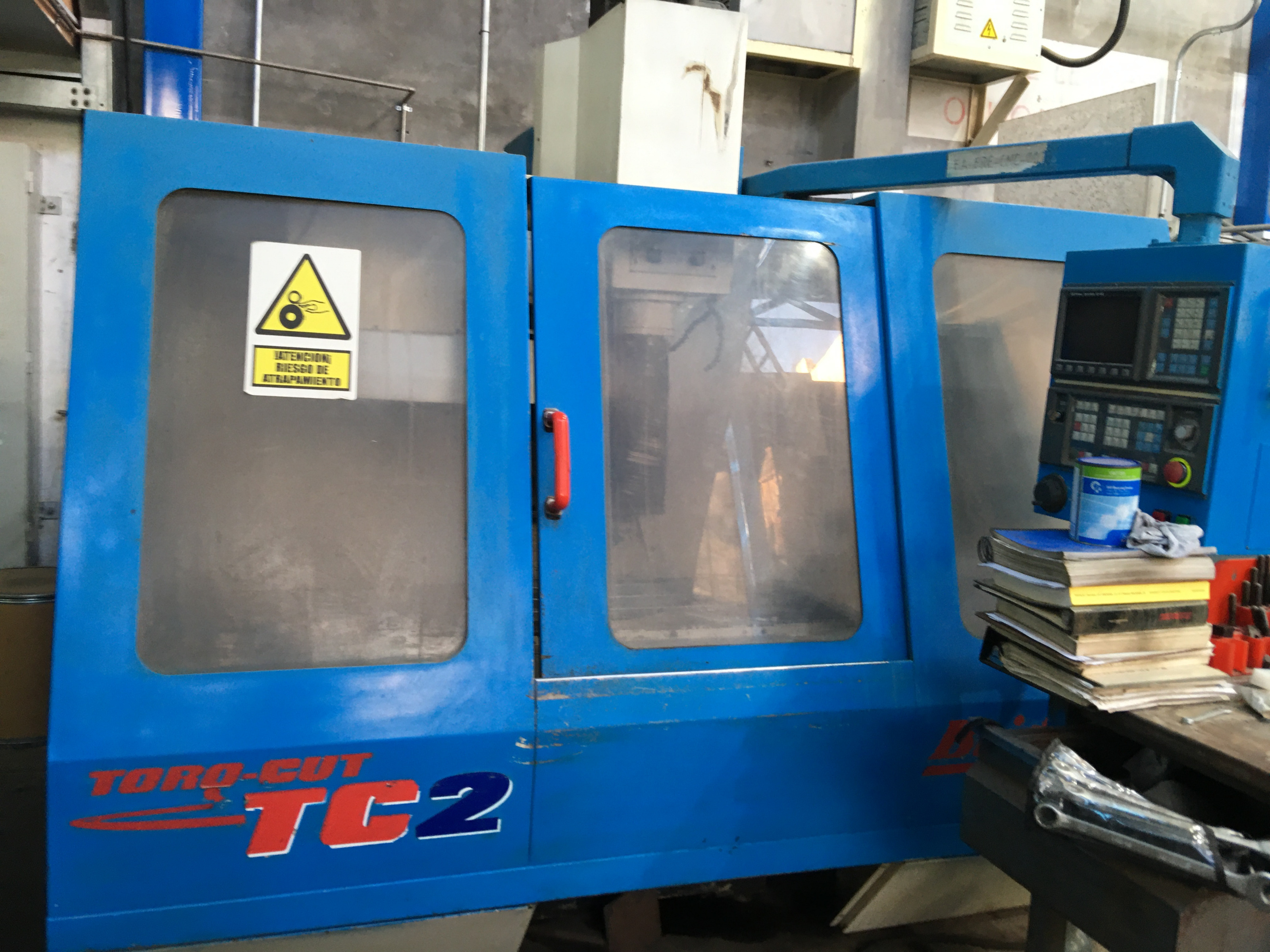

Hello you All. I will retrofit this machine, Bridgepot torcq cut TC2, It has an old fanuc controller (picture),I already have a mesa 7i92 7i77 cards but I've noticed there is no support for linux uspace RT-PREEMPT since 2018.I think of using 5i25 but I could'n find motherboard with pci port, so please I need you to help me choosing another card that works with latest linuxcnc releases, maybe 6i25? .Thank you friends

Actually Preempt-RT is more supported than RTAI currently
so a 7I92+7I77 should be fine

what version of linuxcnc should I use for 7i92?
- Posts: 18122
- Thank you received: 5337
11 May 2022 13:43 #242662
Replied by PCW on topic Retrofit - Bridgeport TC2
The latest ISO (2.8)
