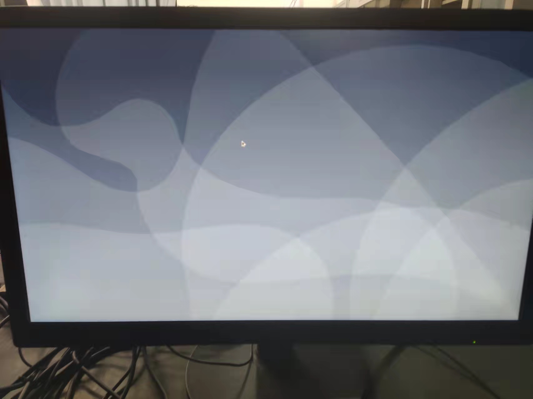

Well, I'm a Linux noob and when I installed the 2.8.2 Debian 10 version using the iso file given by the download page, there was nothing on the desktop, and I didn't know how to unhide them. There must be a panel on the upside and downside of the screen.
I want my desktop to look like this:https://www.tecmint.com/wp-content/uploads/2013/07/xfce-11.jpg
but my screen looked like this:
Does someone help me?

That does not look right, it should have a panel on top full width and one at the bottom that is half width.
Both of them can be set to "auto hide: so send the mouse to the top and to the bottom to check if they are there but hidden.
Otherwise, did you check the md5sum of the downloaded file, might have errors that can cause this.
Also failing memory does that, so if you can, check with only one memory slot at a time.

Possibly the screen is mis-reporting the resolution, and the bars are off the top and bottom of the screen?
You could try switching resolution (if you can figure out how, without menu bars...)

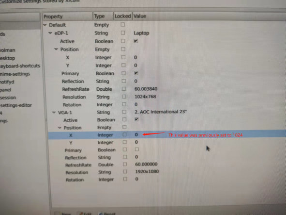

Finally, I found the solution, after devoting my entire day to this.
I show the solution in the picture below.
An offset value of the screen is automatically set after the system is installed, which causes the annoying problem. Set it back to 0, and the problem is solved, eventually.
Thank you for your patience and love you! ! !

You could have mentioned you have 2 screens in use.
