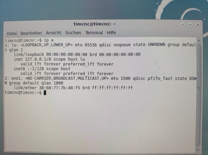

I can´t get a connection to my 7i95. Thought, maybe hm2 has something to do with it.
- Posts: 18080
- Thank you received: 5316
20 May 2022 19:19 - 20 May 2022 19:20 #243419
Replied by PCW on topic synaptic package manager hostmot2
This is most likely a network setup issue.
1. Is the 7I95 jumpered for a 192.168.1.121 address or 10.10.10.10 address?
W16,17 = DOWN,DOWN for 192.168.1.121
W16,17 = DOWN,UP for 10.10.10.10
2. What is the result of typing the command:
ip a
in a terminal
ip a
in a terminal
Last edit: 20 May 2022 19:20 by PCW.

When Mesa card is not connected, this is what ip a says:

I got it. I configured the Ethernet connection as 192.168.1.121. Of course that would not work. Changed it to 192.168.1.111 and it ping as well as mesaflash works.
