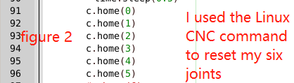

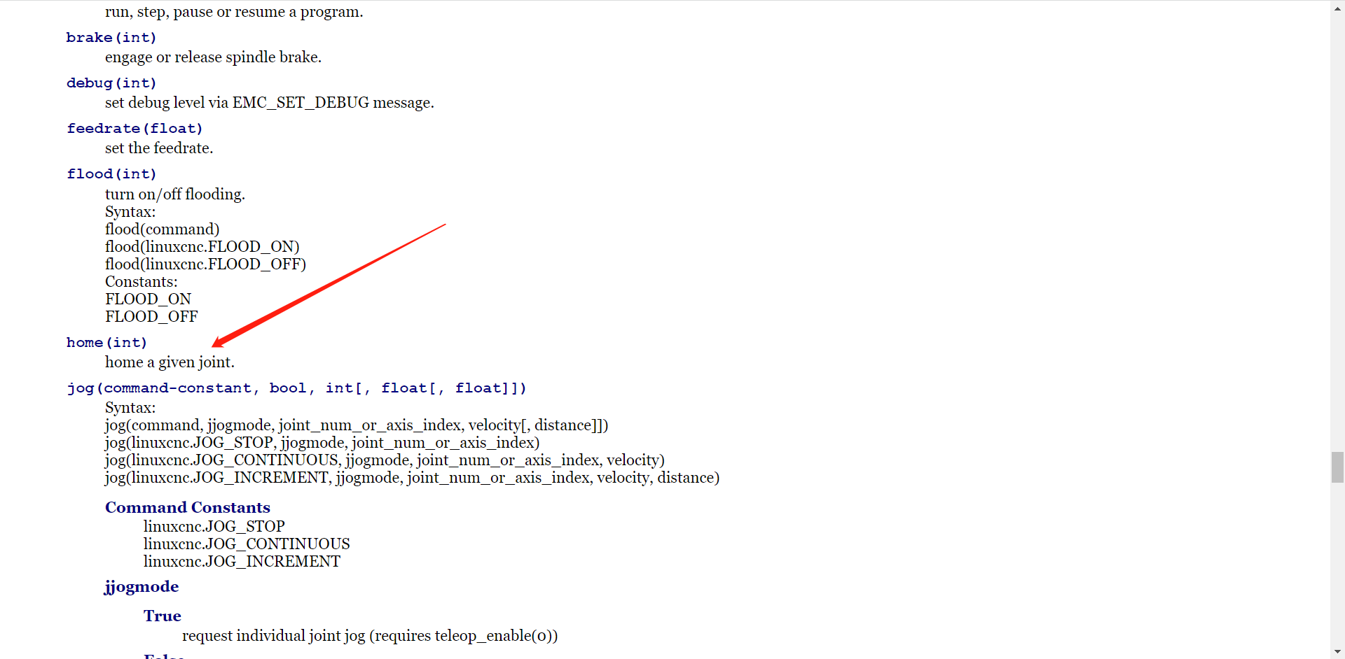

Hi!bro!

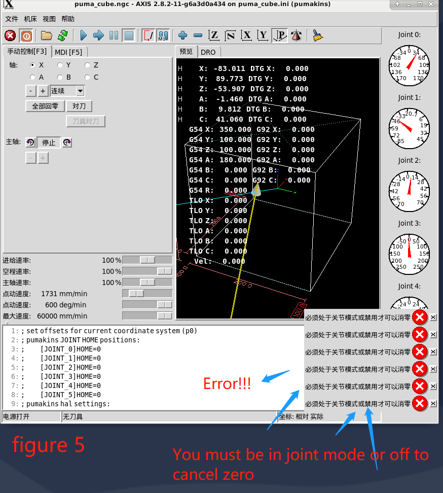

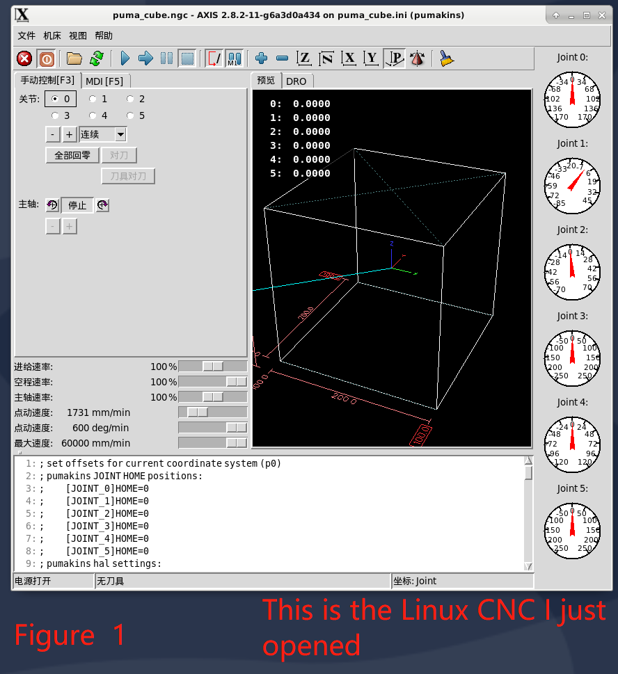

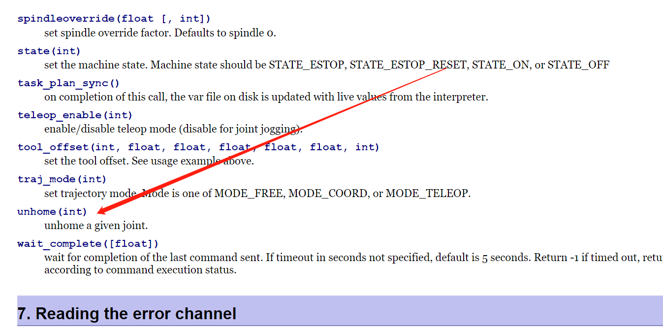

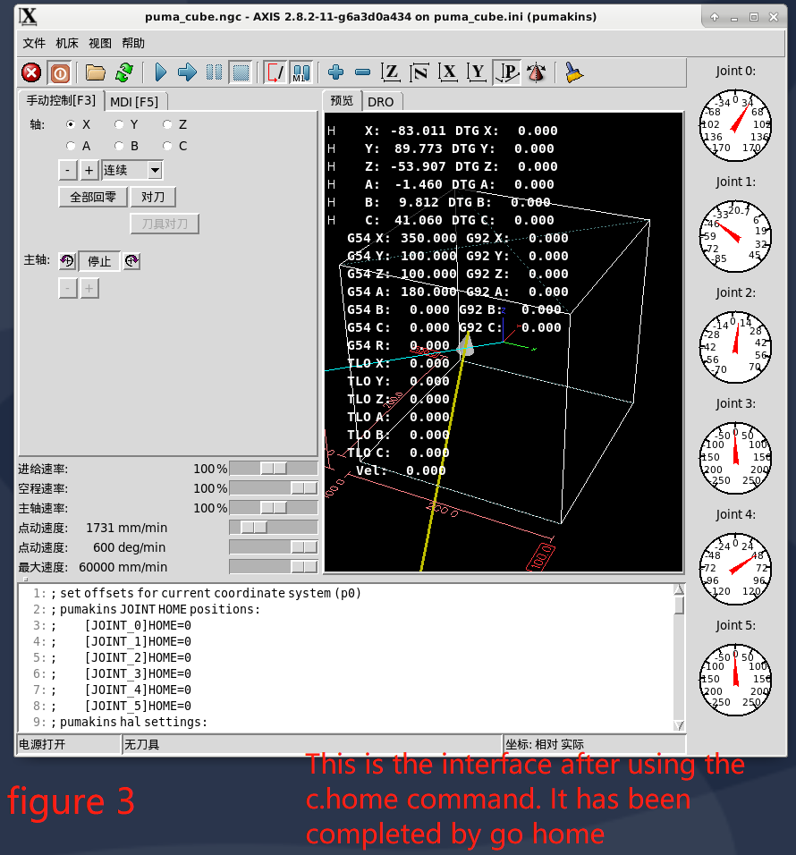

I encountered a difficult problem that bothered me all day。
In short, I used linuxcnc in Python interface command。
When I use the "c.home" command,then I use "c.unhome()", and then the terminal display reports an error, prompting me that "zero can be eliminated only when I am in joint mode or disabled".
However, I tried many functions on the python interface website, but none of them is to enter joint mode or disable it.
Please help me, which command should I use to solve this problem.
This is the python interface website:“ linuxcnc.org/docs/stable/html/config/python-interface.html ”
Thank you!
ps:The following pictures have been numbered in order

24 May 2022 12:37 #243680
Replied by cmorley on topic "c.unhome( )" Command error!

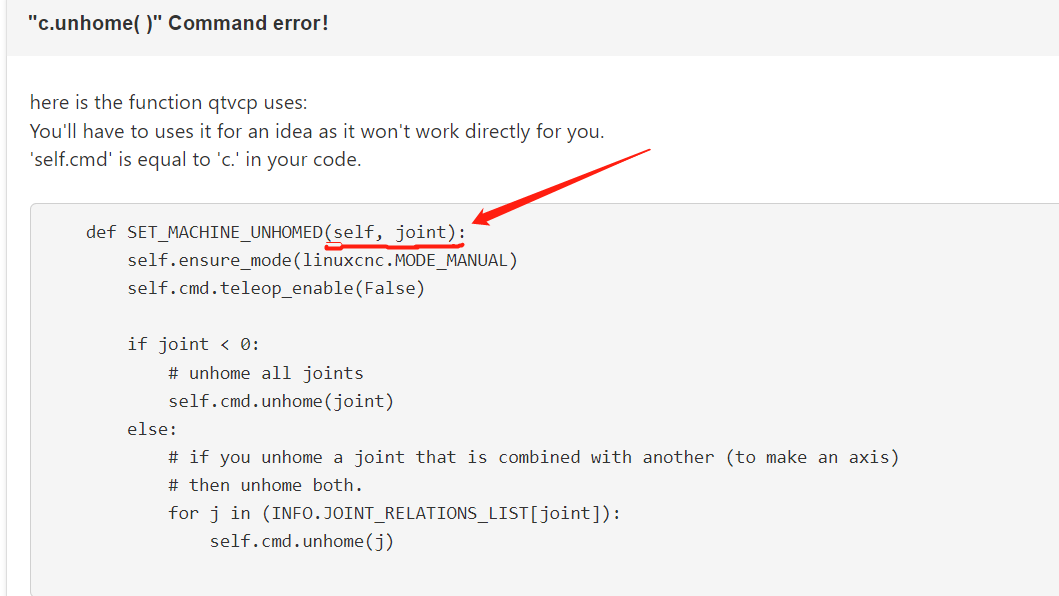

here is the function qtvcp uses:
You'll have to uses it for an idea as it won't work directly for you.
'self.cmd' is equal to 'c.' in your code.
def SET_MACHINE_UNHOMED(self, joint):
self.ensure_mode(linuxcnc.MODE_MANUAL)
self.cmd.teleop_enable(False)
if joint < 0:
# unhome all joints
self.cmd.unhome(joint)
else:
# if you unhome a joint that is combined with another (to make an axis)
# then unhome both.
for j in (INFO.JOINT_RELATIONS_LIST[joint]):
self.cmd.unhome(j)

It's a great honor to get your help, but because I'm unfamiliar with Python and Linux CNC, I still need to ask you questions:
"Set_machine_unhomed" this function has two input values.
I know that "joint" is a joint.
What is "self"? What data should I send into "self"?

25 May 2022 03:47 #243755

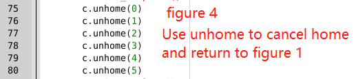

self is there because this function is from a class. 'self' represents the class instance.
But as I said this was to give you an idea what needed to be done.
Let me be more specific - this should work:
c.mode(linuxcnc.MODE_MANUAL)
c.wait_complete()
c.teleop_enable(False)
c.unhome(0)
c.wait_complete()
c.unhome(0)

Thank you very much! Cmorley
You solved my problem perfectly. Thank you very much!
