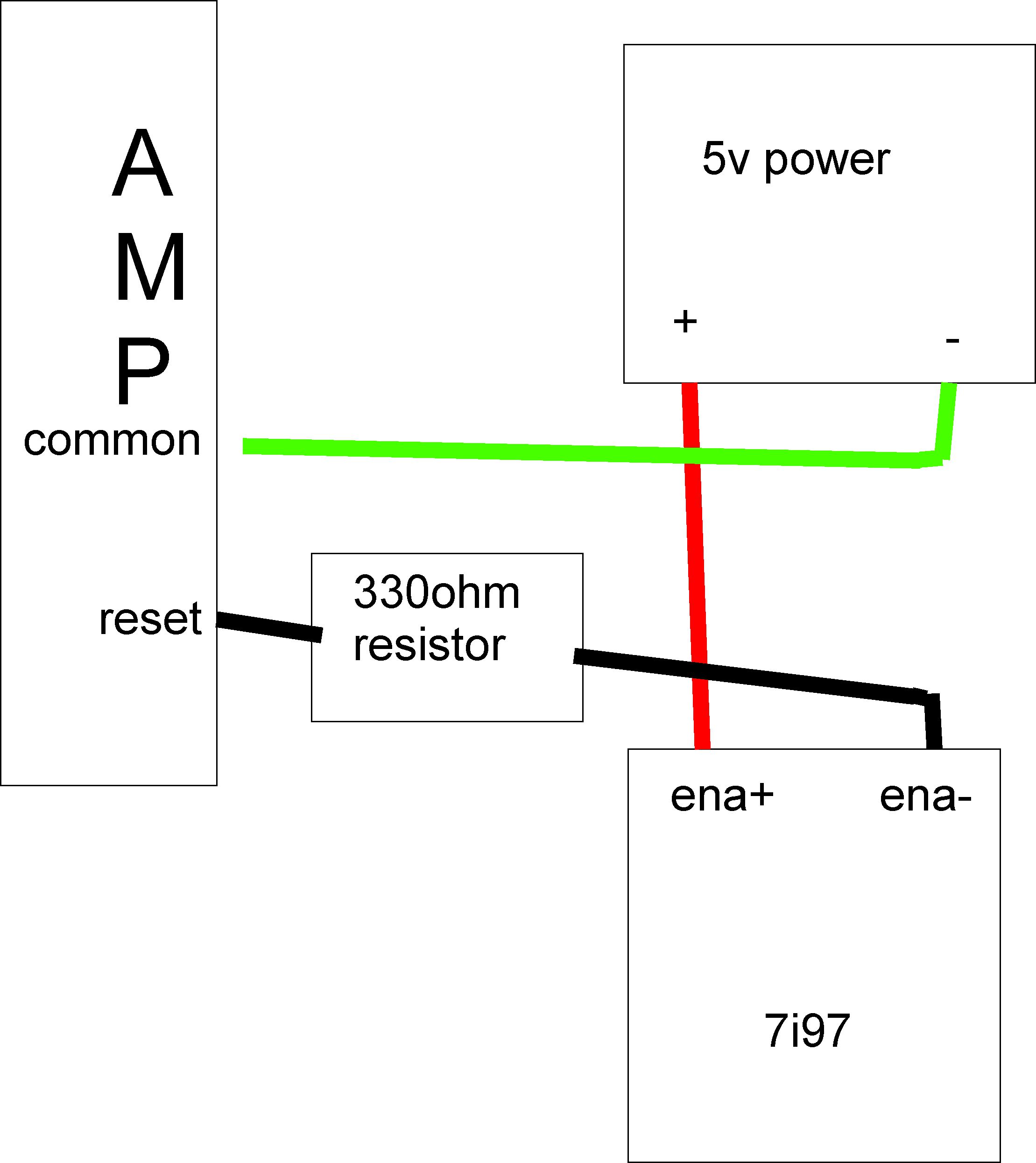

Ive figured out that to enable and disable my amplifiers that there is a fault wire that goes to them. This disables the amps when the wire is pulled up with a resistor. This is kinda new to me but I do get the idea. I just cant think on how I would incorperate this so I could control it with my mesa 7i97. I know it goes to the first two pins on tb3. I dont know how to wire something like this though.

The 7i97 has specific drive enable outputs:

The 7I97 enable outputs are basically switches that are OFF until enabled by LinuxCNC
If you can enable the drives by a combination of a resistor and a switch
(test with a mechanical switch) such that the drive is enabled when the
switch is on, a 7I97 enable output will work (making sure the polarity is correct)

Were you planning on using FAULT or RESET to disable the amp?

It looks to me like reset in mode C (ground to enable) would be a good option
reset --> enable+

So I have to have a special board to hook up in order to switch over to type c mode. I dont have this and have figured out that I am stuck with the type A which says "Type "A": Requires grounding of input to disable the amplifier (pull-up, active-low)."
Since this is the case how should I go about the wiring? Please and thank you

One way to do this is to add a fairly stiff pulldown resistor
to the reset input (say 330 Ohm) so that its normally disabled,
and then to pull up the input with 7I97 enable output (ENA+ to 5V
ENA- to reset input)

24 Jun 2022 17:14 #245800
by Kylizer
Replied by Kylizer on topic Amplifier Inhibit
