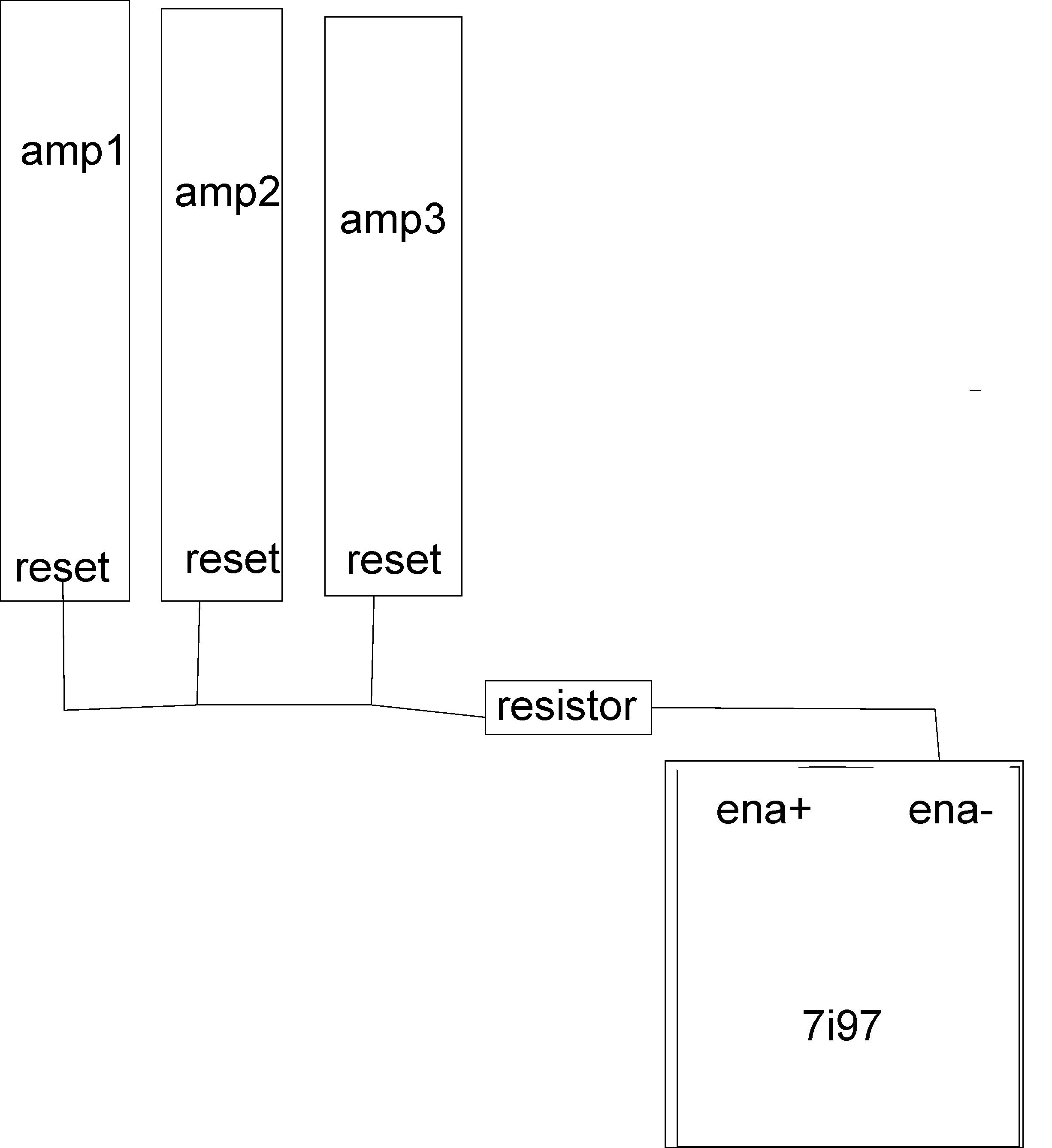

Ok,I got my resistors in. If I am enabling all 3 amps at one time I am assuming this means I need to tie them all together and if this is the case will I just need one resistor after they are all tied together or will I need a resistor for each one and then bring them together?

This is what I have in my head if that wasn't making any sense

I think that you need three resistors.
