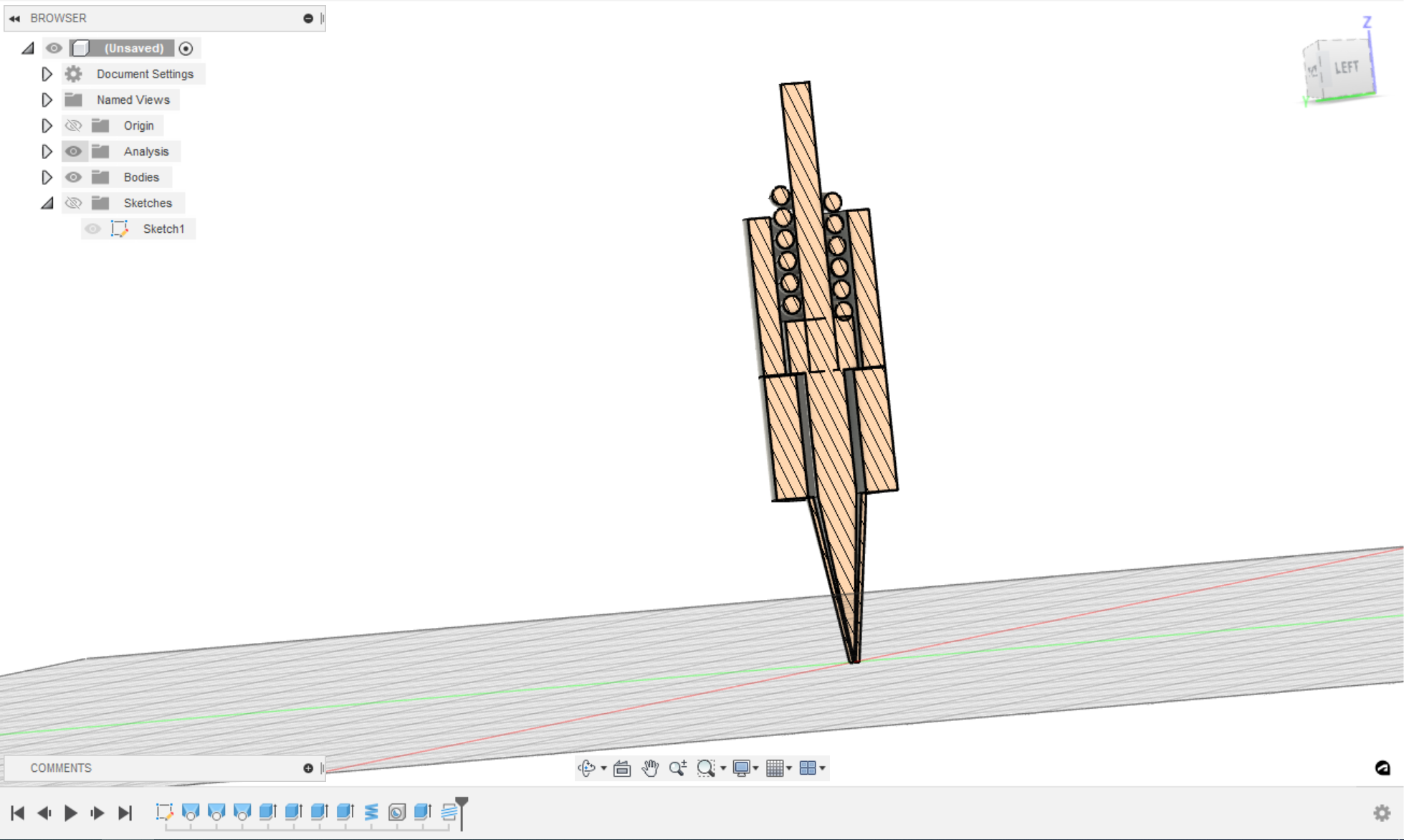

- smc.collins
- Posts: 723
- Thank you received: 139
05 Jun 2022 14:59 #244624
by smc.collins
Replied by smc.collins on topic Adhesive dispensing machine forming adhesive bead, can LinuxCNC solve this?
so, you would make a nozzle where the needle stops directly at the end of the nozzle, this eliminates your reservoiring issue. Conversely if you PWM the solenoid, you can meter a large orifice, and if you alter the size of the origifc and the needle you can really fine tune the delivery. Also you can run the clearance close, or you can change the nozzle geometry and spray or drizzle. I could sketch up some nozzle and valve designs in cad if you want. not very difficult to make. just need a competent lathe operator and some patience. As to how to make it operate, a spring above the needle and a basic plunger type electrical solenoid will get it done
- smc.collins
- Posts: 723
05 Jun 2022 15:31 #244627
by smc.collins
