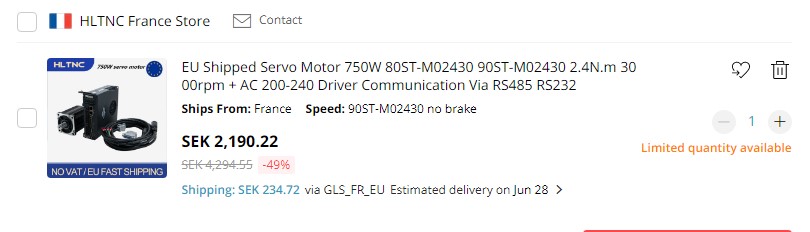

It is now 2022 and I still struggle in my decision in regards of Steppers, closed loop, regular or even servos. Servos are starting to look very price competitive now when you can get a a 750w servo with driver for like 200 Euros shipping included!
I'm about to convert a BF-30MVL (AKA PM-30MVL) and would love to get some advices in regards of motion hardware. I'm familiar with LinuxCNC and have converted a small PCB router and I own a MESA board that I have up and running in lab mode with some NEMA 17's.
Any point having servos on this kind of mill for hobby use?
Is closed loop steppers "the new black" or nearly pointless?
Kind regards/Stefan

I cannot solve you dilemma, but make sure any servos you buy are usable with LinuxCNC. "Driver communication via RS485 RS232" sounds no good. Make sure there's a step/dir, analog (or EtherCAT/other compatible bus) interface.

Go for servos. Because the machine will be much quieter. And the axis can go faster. Precision, about the same.
But look at 80st-m03520 instead of that one, it has a bit more torque and still more than enough of rot speed.
Or even go down in size to 500w.
The servos need to be tuned though but there are plenty of people here that find that easy and can help.
