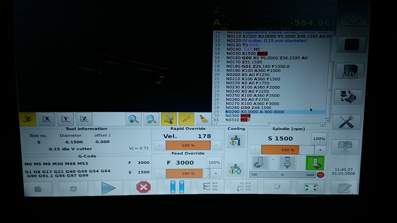

Dear Friends,
I am presently running my machine rotary axis.
Now a g-code is attached. G93 is there in the Gcode.
Point 1: When I run the code, G93 is not active at least not showing in Gcode list of the window, rather G94 is showing there (photo attached). Why??
Point 2: Again even if G94 is working, the feed shows 3000 in all lines and velocity 625 in all lines. Why?? The program has different feed of 1000,1250,1500,1750,2000,2250,2500,2750,3000 in different lines.
- Posts: 19896
- Thank you received: 4648
21 Jul 2022 09:24 #247923
Replied by andypugh on topic Rotary Program Feed rate question
Taking the points in reverse order
linuxcnc.org/docs/stable/html/gcode/g-co...ml#gcode:g93-g94-g95
G93 requires an F number on every motion line.
Also, F-numbers on non-motion lines are ignored.
The status box shows interpreter state. Often the interpreter will have already finished before the motion even starts. M2 resets to G94, so if the interpreter has finished and queued the M2 it will show G94.
If you add a probe move into the code you will probably see the status show G93 until that is complete.
Interpreter status info is only really useful when the machine is not currently running g-code.

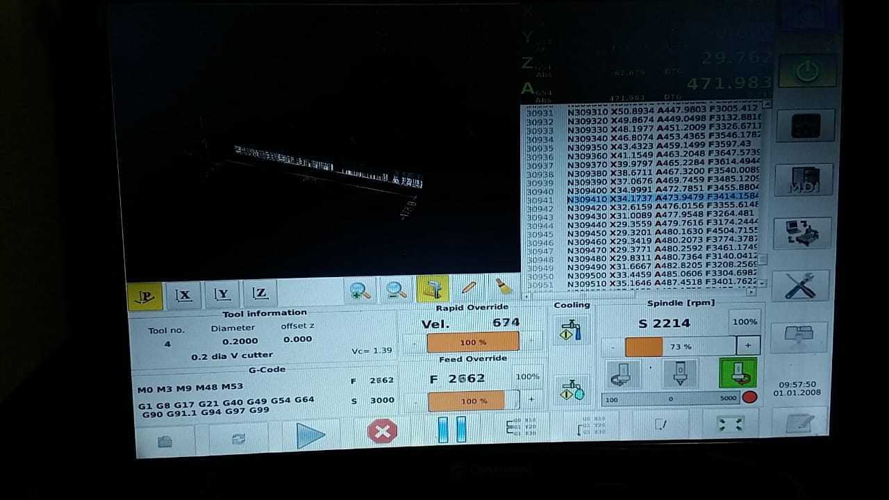

- rajsekhar
- Posts: 206
- Thank you received: 12
24 Jul 2022 06:46 #248155
by rajsekhar
Replied by rajsekhar on topic Rotary Program Feed rate question
Dear Andy,
I just make it clear that as per confirmation from sheetcam, F numbers are in unit/min mode and not in inverse feed. I will start a discussion with sheetcam on how they calculate the F numbers.
Now, I have generated Gcode with feed 1250 and 2500 (mm/min) for the same job. Run both the gocode one after another. Same time is taken although F numbers in G code files are not same. Photo (video exceeds size) of computer screen is attached.
What is the correct explanation?
