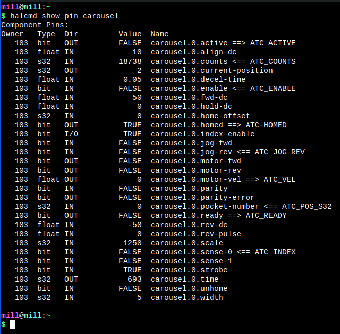

If you're not sick of this yet, the same problem is back.  [Fresh install of MX21 & LCNC 2.10]
After a long hiatus and a new operator console, I'm at the point where I can finish up my ATC.  Using the same ATC settings as last summer I attempted to do some testing.
Discovered that the carousel only moves in one direction.  Jog-FWD & jog-REV both cause REV movement, and commanding a pocket change by setting carousel.0.pocket-number to a value which should result in FWD movement results in REV rotation.
As I mentioned last July all the pocket pins have been removed - just a home pin and a single sensor.  Carousel still set to counts.
loadrt carousel                     pockets=18 encoding=counts num_sense=2 dir=2
setp carousel.0.scale       [ATC]ATC_SCALE      #stepgen pulses per pocket
setp carousel.0.width       5 #[ATC]ATC_WIDTH      #width is tolerance 'window'; set higher for faster speeds
setp carousel.0.fwd-dc      50 #[ATC]ATC_VEL_FWD    #degrees/second if stepgen position-scale set to degrees
setp carousel.0.rev-dc      -50 #[ATC]ATC_VEL_REV    #degrees/second if stepgen position-scale set to degrees
setp carousel.0.decel-time  0.05 #[ATC]ATC_DECEL      #time to wait for carousel to stop before final alignment
setp carousel.0.align-dc    10 #[ATC]ATC_ALIGN_DC   #slow speed for alignment to sense-0 or sense-1
After homing and unhoming, and trying to jog fwd/rev and setting the pocket number then 'enable' a few times, it gets stuck at state = 20 and won't respond at all.
I tried setting num_sense=1 but got an RTAPI_MP_ARRAY_INT error.
I see you made some edits to carousel.comp around September based on an issue reported on github - that would have been after I had my last configuration sort-of working.  Anything obviously wrong you see in my above settings?
I was under the impression that in counts mode only an index pin is required.  Is this not the case?
Thx,
R
20 Jan 2023 05:49 #262472 by andypugh
Replied by andypugh on topic carousel.comp - jog-FWD still an issue
I don't think that align-dc can be used with only an index pin.
Try setting that to zero and see what happens.
20 Jan 2023 05:54 #262473 by andypugh
andypugh post=262472 userid=723I don't think that align-dc can be used with only an index pin.

If it is stuck in state 20 then it is waiting for exact alignment to the stepgen counts.
case 20: //jogging fwd/rev
        if (current_position != target) return;
        if (align_dc != 0 && ! align_pin) return;
        motor_fwd = 0;
        motor_rev = 0;
        motor_vel = hold_dc;
        active = 0;
        if (jog_fwd || jog_rev) return; // require button release to jog again
        if (align_dc != 0) {
            motor_vel = -align_dc;
            timer = decel_time;
            state = 5;
        } else {
            state = 0;
        break;
Can you grab a snapshot of the pin states when it is stuck?
Open a terminal and "halcmd show pin carousel*" and paste the result here.

20 Jan 2023 06:40 #262478 by spumco
Replied by spumco on topic carousel.comp - jog-FWD still an issue
Forgot to mention: I'd already tried it with align-dc set to 0, and decel set to 0 or 0.05.  the jogs look fine (right number of steps), just everything is one direction.
I guess it's possible the DIR pin came loose...  I can test this by connecting directly to drive with usb and seeing if it'll move in both directions.
halcmd attached.
20 Jan 2023 07:01 #262483 by andypugh
Another way (the stepgen pin name will need to be changed to suit your actual system)
With LinuxCNC loaded.
halcmd unlinkp stepgen.0.velocity-cmd
halcmd setp stepgen.0.velocity-cmd 20
halcmd setp stepgen.0.velocity-cmd -20
halcmd setp stepgen.0.velocity-cmd 0
halcmd attached.
And that was with it stuck in state 20? That's wierd...
