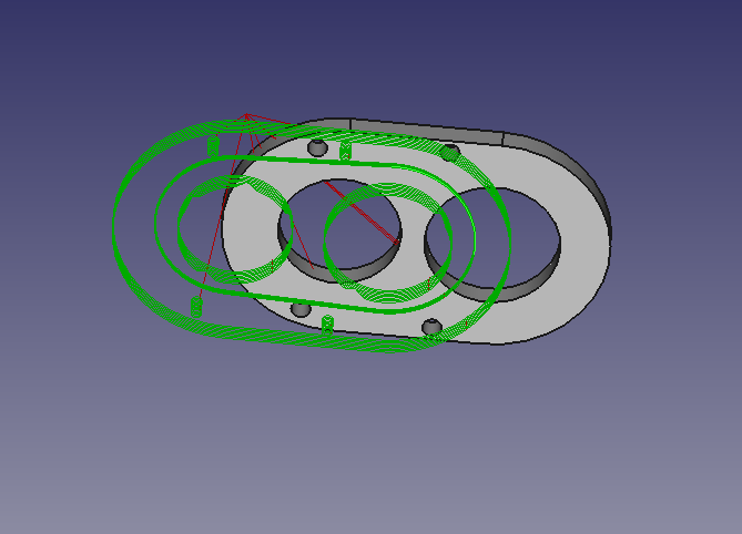

Hi everybody,
I drew a part in Freecad and the green lines representing the Gcode in Freecad look right.
When I load the GCode in Linuxcnc there is an error.
Is this a bug in Linuxcnc?

No, an arc is not correct in your G code. The error is with your CAM softwaer. Try setting the precision in your CAM software smaller.
