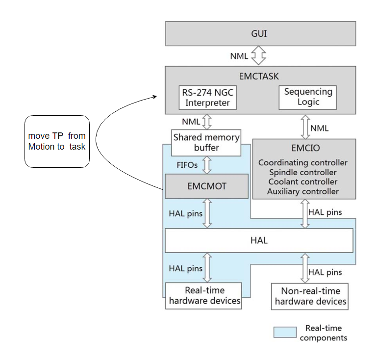

Move Trajectory planner from real time to non-real time

20 Jul 2022 07:46 #247839
Replied by andypugh on topic Move Trajectory planner from real time to non-real time
Have you checked to see if machinekit have already done this?
The following user(s) said Thank You: troy
- Posts: 7368
- Thank you received: 2182
20 Jul 2022 08:04 #247843
Replied by cmorley on topic Move Trajectory planner from real time to non-real time
How will you handle such things as override and spindle sync?

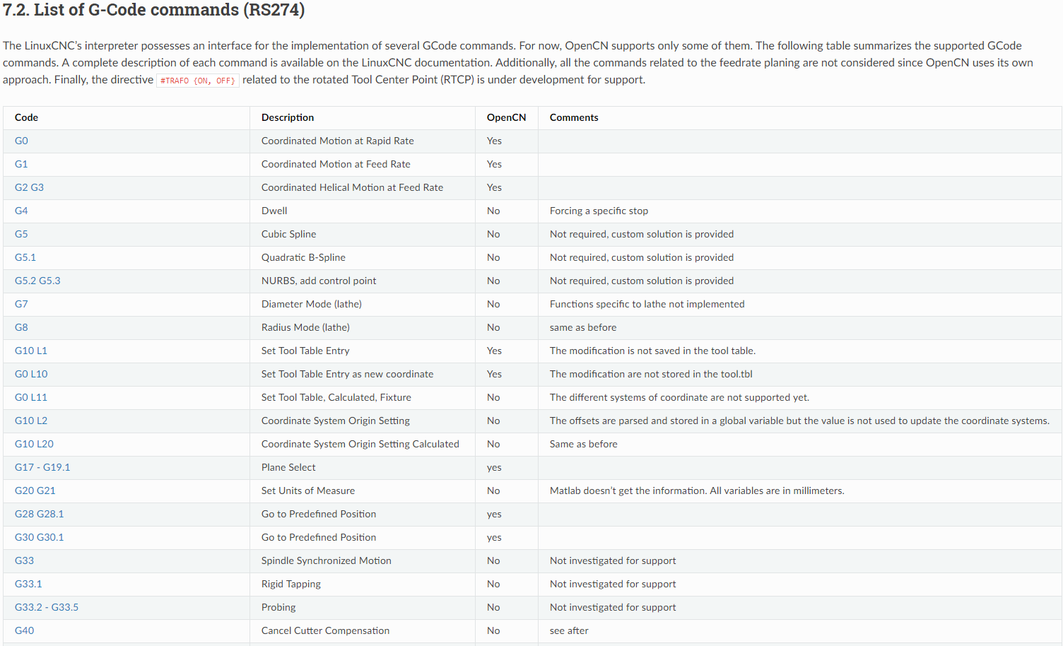

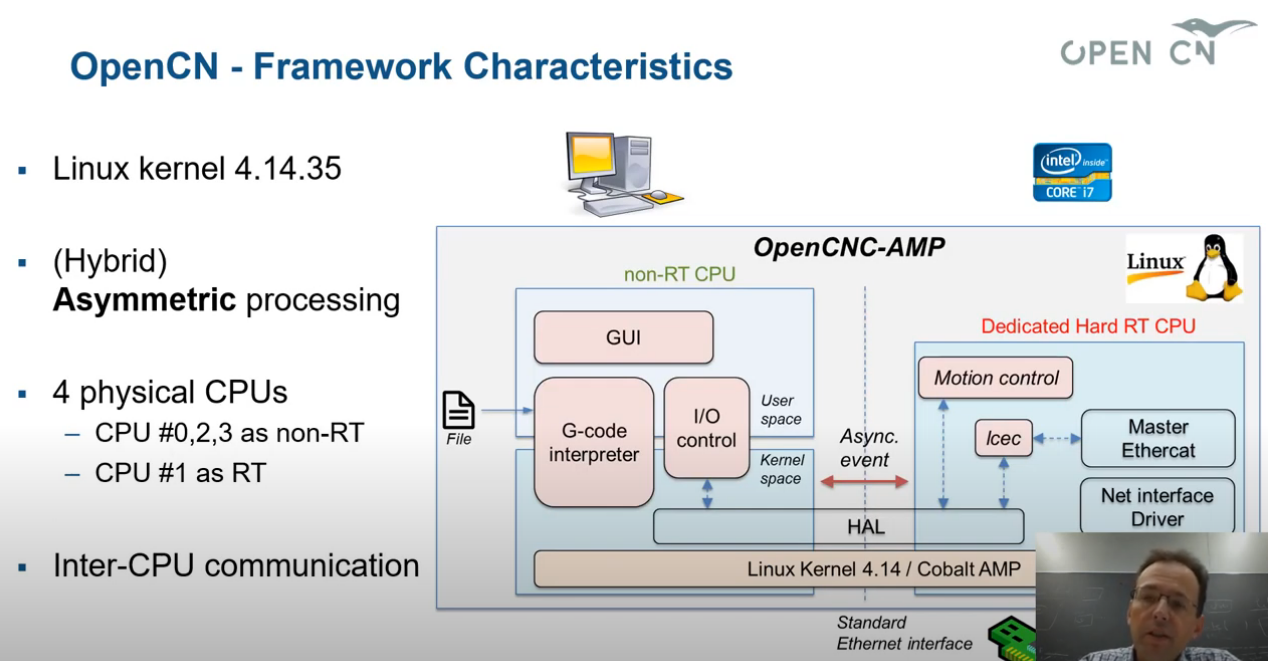

- Posts: 18122
- Thank you received: 5337
20 Jul 2022 09:15 #247848
Replied by PCW on topic Move Trajectory planner from real time to non-real time
I think the LinuxCNC derivative "OpenCN" does something similar
(it seems to trade off real-time planning to simplify things like jerk control)
