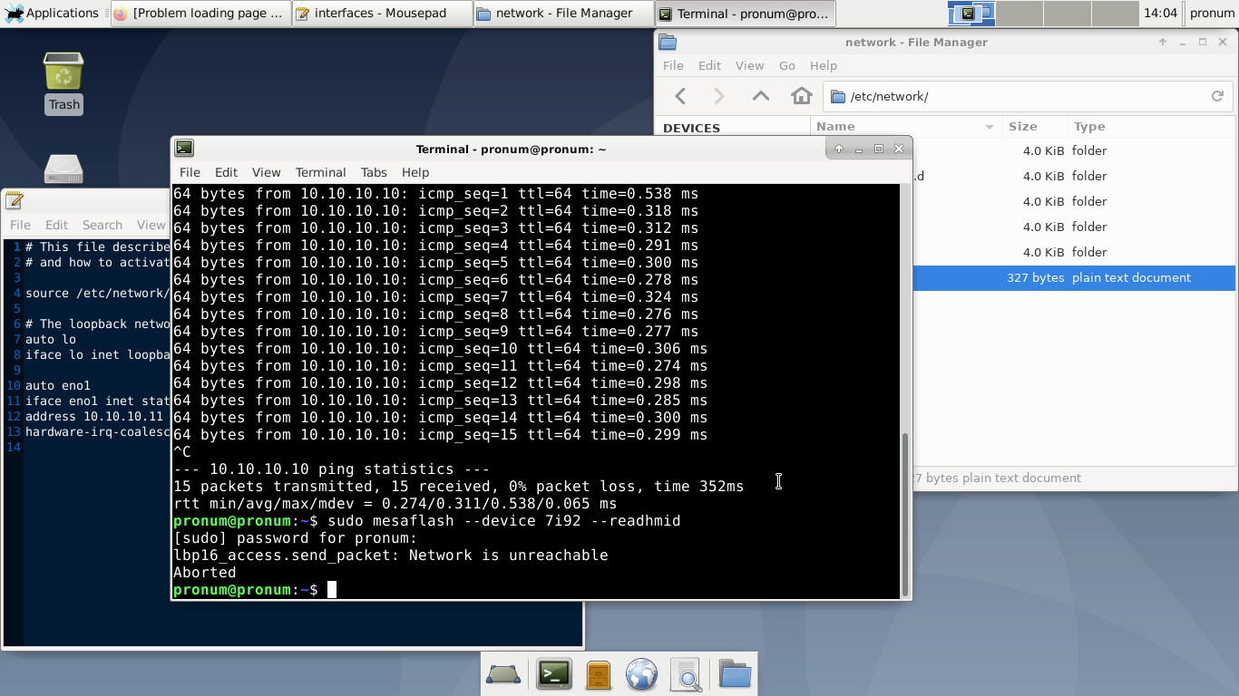

Hi, I am using a 7i92h mesaboard with a 7i76 to add stepgen. I've just configured the linuxcnc.
Can't check the ports into the 7i92 board with mesaflash command:
- sudo mesaflash --device 7i92 --readhmid
I've tried: sudo mesaflash --device 7i92 --reload
It appears the same thing.
lbp16_access.send_packet: Network is unreachable
My network config is:
auto eno1
iface eno1 inet static
address 10.10.10.11
hardware-irq-coalesce-rx-usecs 0
Can ping to the board as shown in the picture in attach
I've installed the mesaflash by adding
sudo apt install mesaflash
Can someone help?
For more info needed, just ask
Thank you

The command would be:
mesaflash --device 7i92 --addr 10.10.10.10 --readhmid
