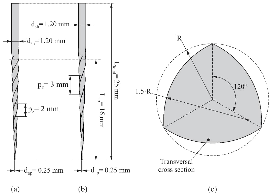

HiI don't have access North America and Europe so I can't buy mesa or picosystems boards.
considering that, what is the minimum requirements for using linuxcnc to make a 5 axis closed loop cnc?
I have delta asd-a3 400w servo drivers and motors which have abs encoders and use opencan and rs485
Also i have access to Chinese boards like nvum or nvem
And some boards like intel altera cyclon v4

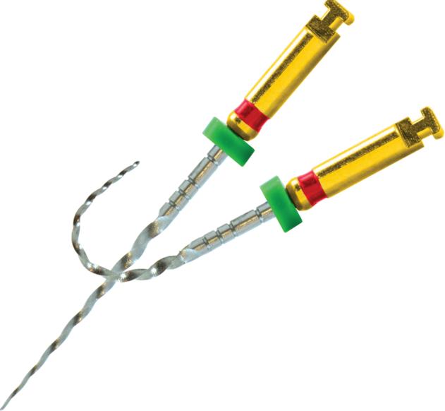

i also attached workpiece pictures.
It is e ndodontic rotary file made of niti .
Thank you.
Thank you.
