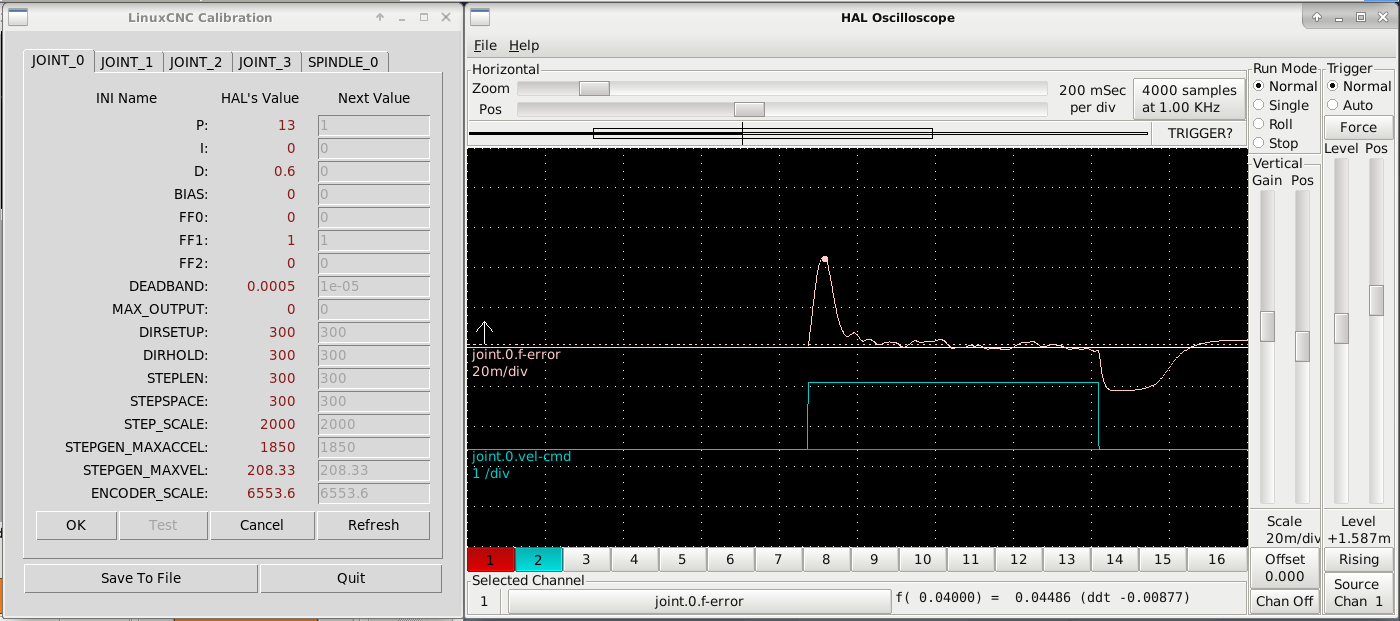

Im trying to PID tune my machine but im having issues with the FF2 variable.
From what i can understand from guides FF2 would be used to remove the spike of ferror that occurs at the beginning and end of a movement. I have also read that very small amounts of FF2 should be applied. For me however, the FF2 term does not change the characteristics at all.
Here is my current baseline with FF2 at 0 and a slow move at 100mm/min:
As you can see there is a spike at the beginning and end of movement. The ferror at the top of the spike is 0.0446mm

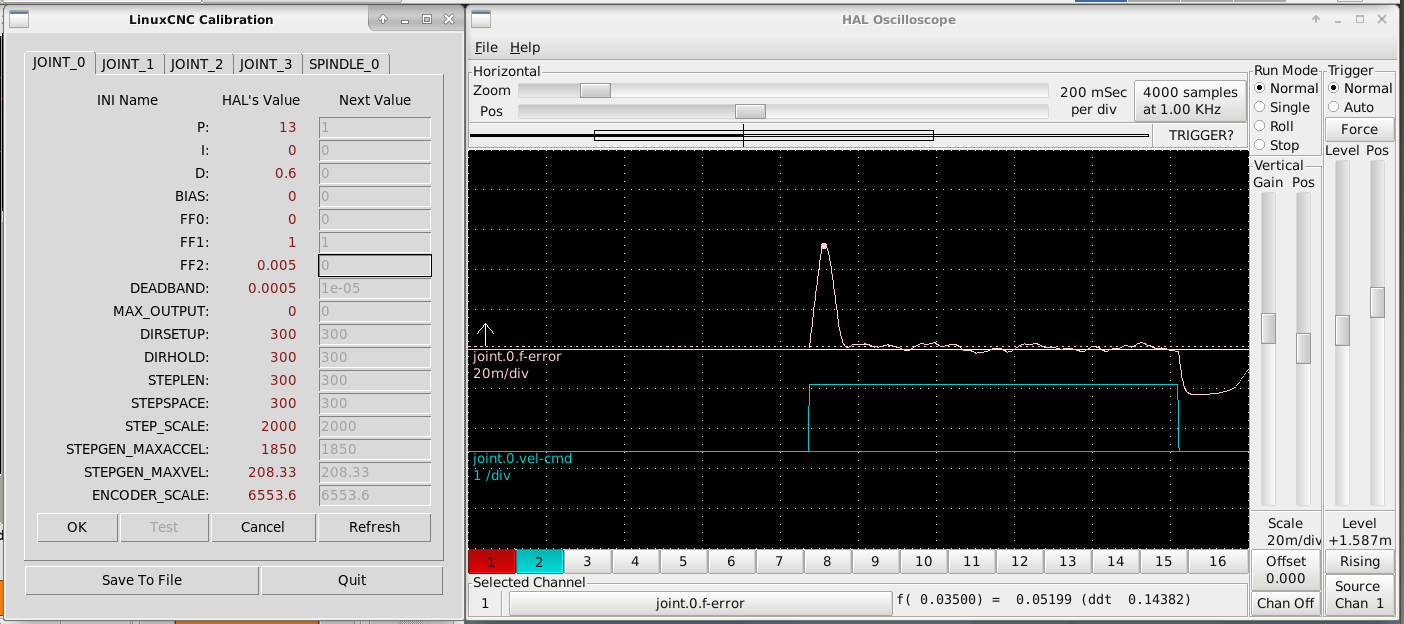

If i change FF2 to 0.0005 the ferror is slightly higher. That may just be that perticular move, i have seen that the error can variy slightly. Anyway, its not lower.

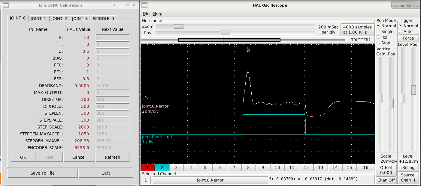

Just to make a point i set FF2 to 0.5 with the spike again being unchanged.

To me it seems that setting FF1 to 1 removes the possibility for me to tune FF2 at all. With this being a Step/dir controlled system FF1 being anything other than 1 causes problems of its own. But it seems to me that the FF2 value gets less and less influence the closer FF1 comes to 1. Could be something? could be nothing..
I am sure that i have made a mistake somewhere but i just cant find it.
Hal and Ini files are attached.

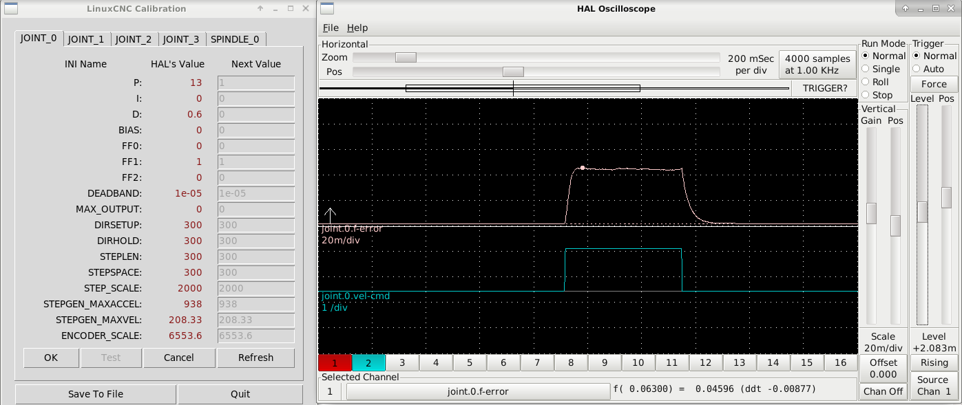

How do the servos perform with the config set for open loop? (using the stepgen's position feedback for the PID's position feedback.) You can still keep the encoder feedback connected to the joint position feedback, and use it to monitory the f-error. This could confirm that the problem is indeed in the drive's tuning.

If i do that i get this:
Im not entirely sure what it means though. I can see the same amount of ferror as i get at the top of the spike. Does this mean that the servo is "lagging" 0,045mm all the time in relation to expected position?

Yes, sort of. Some lag, is unavoidable. There is always going to be some lag between when the position is commanded, processed, movement made, feadback is read, feadback processed, and following error calculated. At the very least a servo thread cycle or two. So some error proportional to the velocity is unavoidable. The trick is figuring out what is realistic and acceptable. So 0.045 is about 10x what I would expect (assuming I read correctly that your move was at 1.5mm/sec.)
Another thing to consider when you are tuning the closed loop PID loop in Linuxcnc. You should probably look at the PID error rather than f-error. They are not calculated the same and the PID error will lag the f-error by a servo cycle. The result can be frustrating when you think you see following error but the PID loop is not doing anything about it because it is looking at a different error calculation.

I want to rephrase my statement, 0.045mm is about 10x what you could expect from a near perfect response. (Which probably isn't possible either.)
