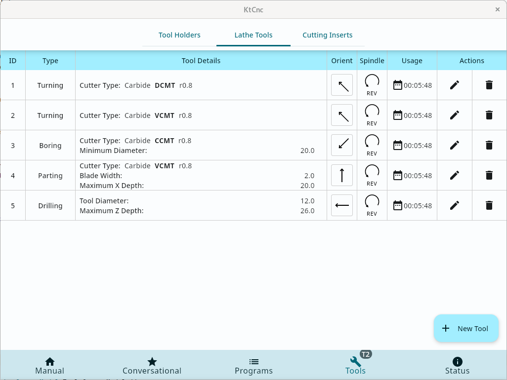

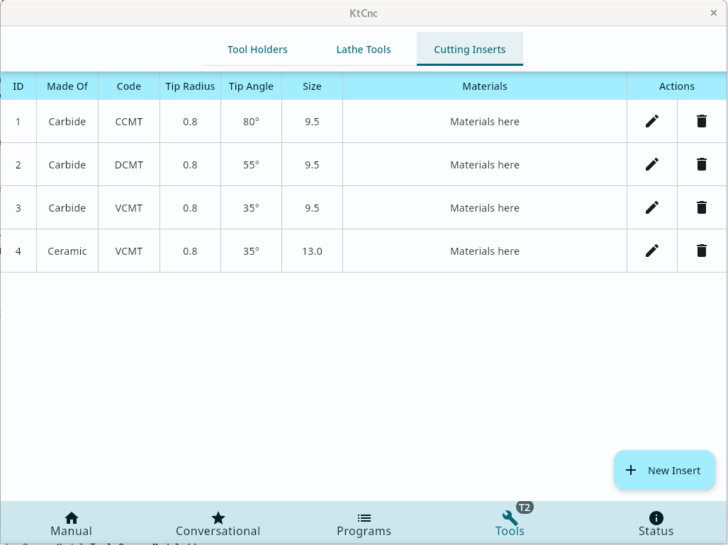

My lathe has a front tool post, with a multifix toolpost. And since only 16 tool holders and way more lathe tools, I decided to make the software aware of that. Therefore you can have a list of tools, and you can associate a specific tool with a specific holder. Only at that time a tool has offsets and its ready to be used. Also the lathe tools can have inserts, and those inserts have feeds and speeds for the materials they were designed to cut.Therefore I included all this info in my custom tool library so that I can use it further when I will start to implement the conversational logic, to suggest cutting parameters between a min-max range.

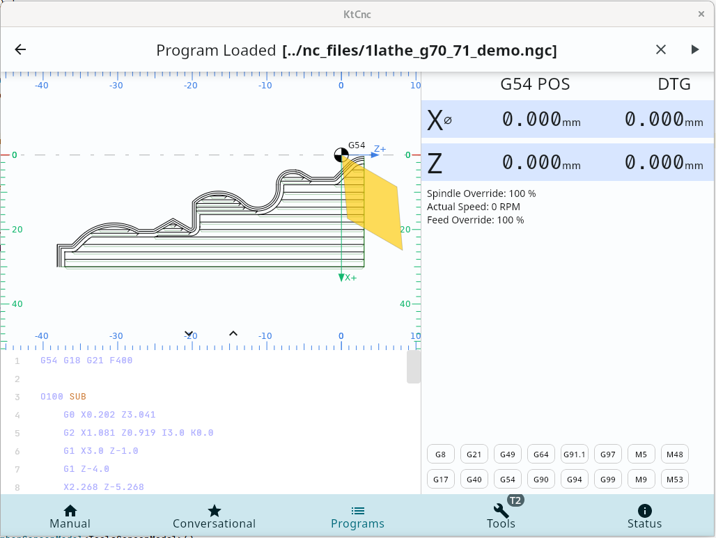

As you can see in the screenshots below, I am rendering the toolpath along with the insert of the current tool. The angle of the yellow insert will be taken from the tool library, but I also need to set the back angle and the front angle so that the visual orientation of the insert is correct. My initial understanding was that I would have something like FrontAngle+InsertAngle+BackAngle = 180deg
Upon reading some more, I think I don't understand properly the notions of FrontAngle and Back angle...
So if someone can explain, I would be grateful.

I think that both frontangle and backangle are measured relative to the Z axis.
And the insert angle will be the difference between them.
