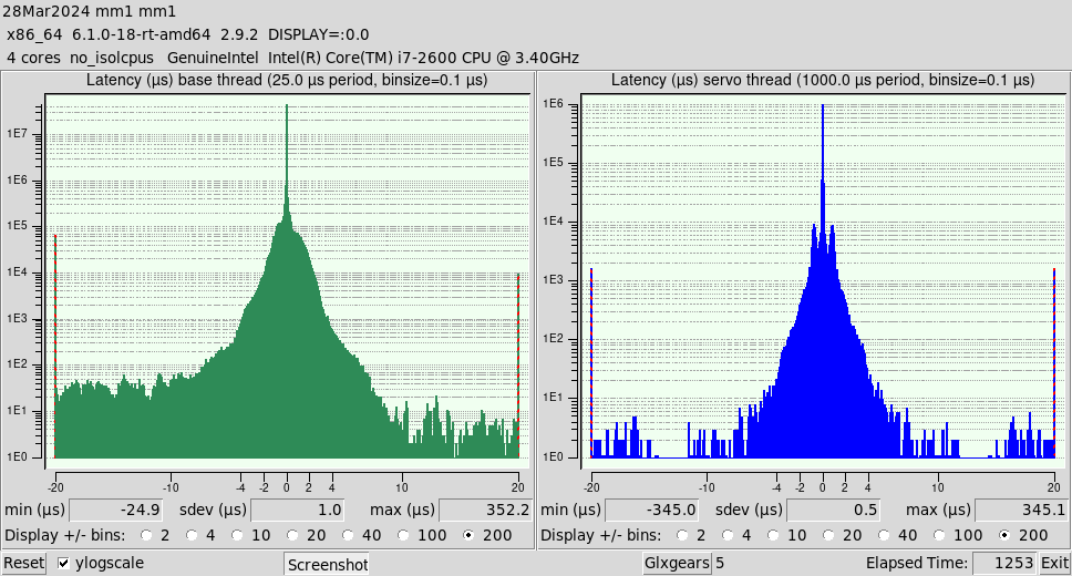

27 Mar 2024 22:35 #296948 by moazzam
Replied by moazzam on topic Cannot seem to get good latency numbers!
Hi
Could somebody please see the figures and guide me about my system latency :
Max Jitter for Servo Thread (1ms): is 332463
Max Jitter for Base Thread (25us): is 346784
Histogram is
Is it good , bad or ugly to use this computer.
27 Mar 2024 23:55 #296956 by tommylight
Replied by tommylight on topic Cannot seem to get good latency numbers!
From bad to ugly! :)
Enter the BIOS (search for you PC how to) and disable hyperthreading, TPM, virtualisation all, turbo, power saving everything, and something with "aggressive link management" regarding PCI-E.
The following user(s) said Thank You: moazzam

28 Mar 2024 11:39 #296986 by rodw
Replied by rodw on topic Cannot seem to get good latency numbers!
also set isolcpus=2,3 in your boot options. The 2.9 iso has grub-customizer included to simplify this
