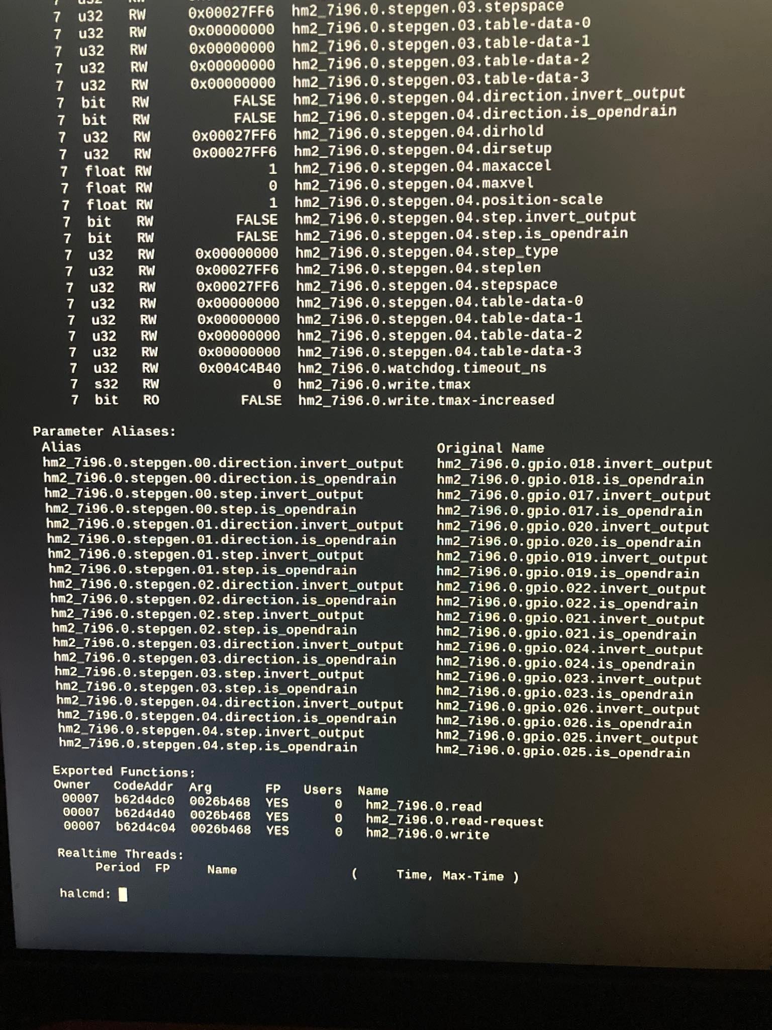

Replied by prochj51 on topic Setup spindle on Mesa 7i96s and Linuxcnc 2.8.3
I am on raspberry Pi 4 and hm2_7i96s throws me an error.
When I do for example
LinuxCNC fails with pin hm2_7i96s.0.watchdog.timeout_ns is not found
halrun
loadrt hostmot2
loadrt hm2_eth board_ip="10.10.10.10"
setp hm2_7i96s.0.watchdog.timeout_ns 5000000

20 Aug 2022 17:00 #250114
Replied by PCW on topic Setup spindle on Mesa 7i96s and Linuxcnc 2.8.3
Did the hm2_eth driver load properly?

20 Aug 2022 17:47 #250116
by prochj51
- Posts: 18080
- Thank you received: 5316
20 Aug 2022 18:14 #250117

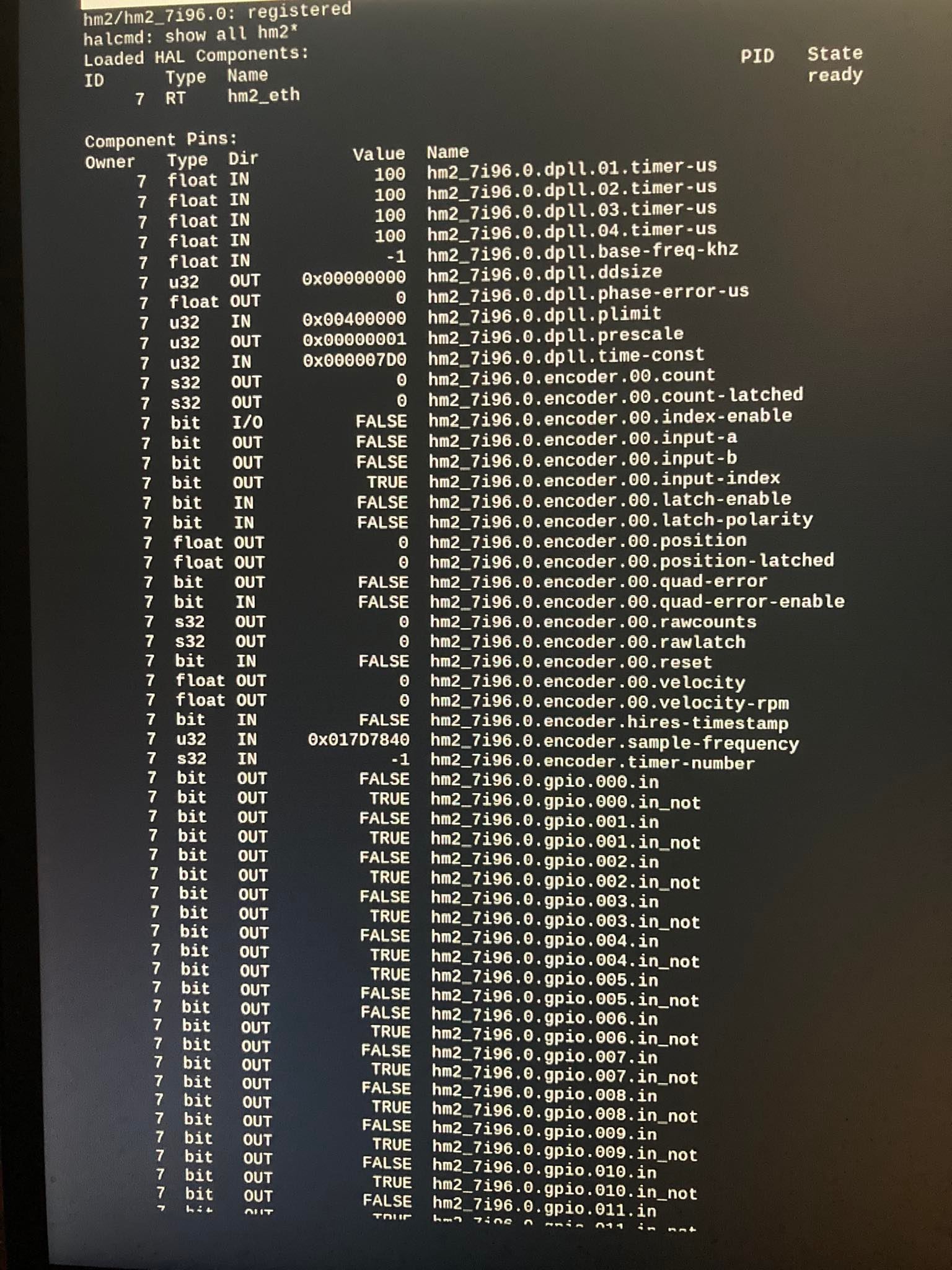

Ahh there may be other name errors
You might try:
show all hm2*
(or upgrade to 2.9)
You might try:
show all hm2*
(or upgrade to 2.9)

20 Aug 2022 18:43 #250118
by prochj51
- zz912
- Posts: 596
- Thank you received: 98
21 Aug 2022 12:12 #250150
by zz912
Replied by zz912 on topic Setup spindle on Mesa 7i96s and Linuxcnc 2.8.3
Exist way to use stable version 2.8 and 7i96s . But you must use RIP install.
1) Check if you have debian installation of LCNC.2) if it finds something, uninstall it3) Download branche 2.8 from github
4) Unzip it
5) Build LCNC
linuxcnc.org/docs/stable/html/code/building-linuxcnc.html
I struggled a lot before I managed to compile LCNC. It took me a lot of time. But now I only use RIP installation and I can say that the time spent learning RIP installation paid off.
6) Try to run Gmoccapy. For example the Gmoccapy sim.
If it doesn't work, install this:
forum.linuxcnc.org/gmoccapy/46202-buidli...-2-rip-with-gmoccapy
If Gmoccapy will work, it's already fixed. Andypugh tried to help me, but I didn't understand what he was trying to say.
7) Integrate Mesa driver from 2.9
github.com/LinuxCNC/linuxcnc/pull/1899#issuecomment-1220953437
8) Rebuild LinuxCNC
I recommend RIP installation for everybody.
