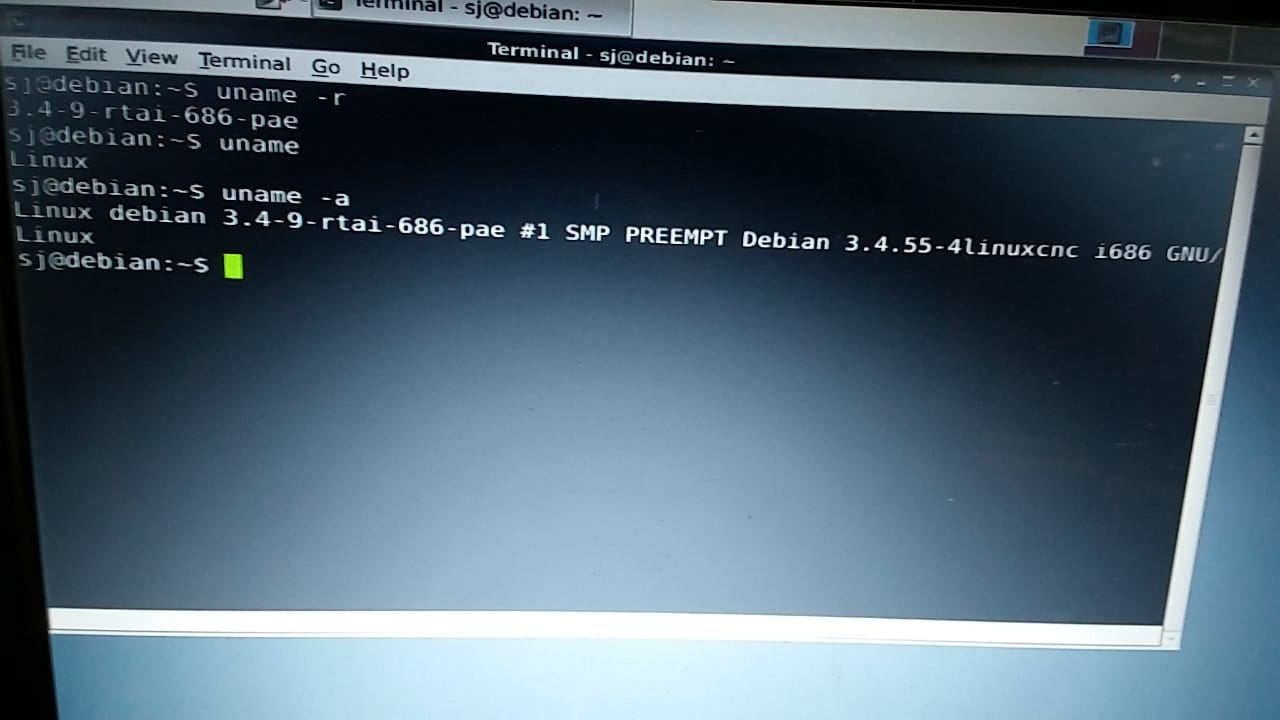

24 Aug 2022 06:41 #250303
by rajsekhar
Replied by rajsekhar on topic G code from Pen drive
Please refer the attached photo for version.
I had installed debian wheezy 7 with RTAI, then updated and using GMOCCAPY.

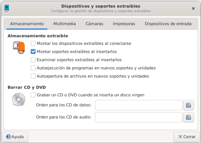

- tatel
- Posts: 33
- Thank you received: 16
28 Aug 2022 00:08 #250598
by tatel
Replied by tatel on topic G code from Pen drive
