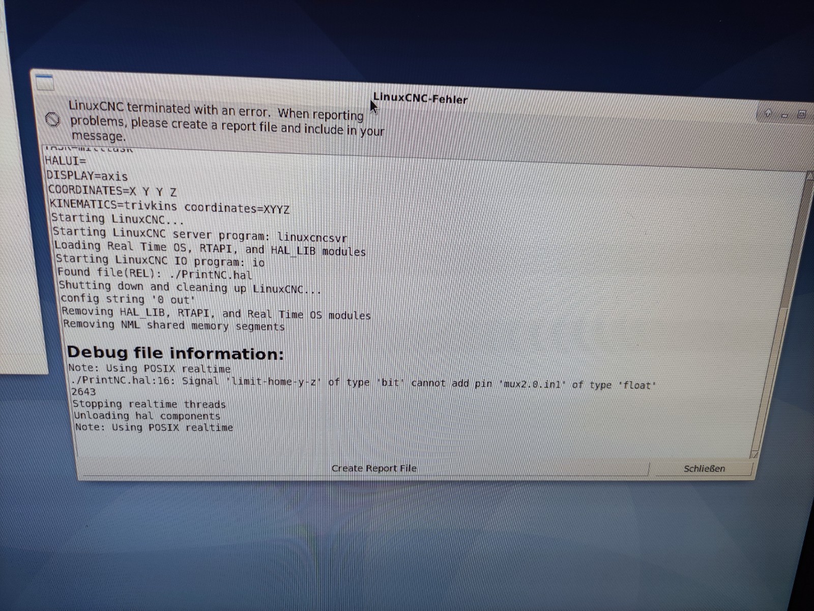

Hello togheter,
now i installed 2.8.2 and it seems like my configuration is working now.
But i have a problem with my home-signals.
I want to share pin inputs because i dont have much on the bob.
I tought to use:
Pin10 for y2 and x
Pin11 for z, y1 and my tool probe over traveling
Pin12 my tool probe
I understand, that i have to link the pin signal to a variable and then the variable to my net min-home.
I also tried something but i have a type missmatch. bit and float. I dont think i can do a typecast in linuxcnc?
Actually I try to link z and y1 signal so i could reference my z axis. (step by step i think if i can manage that the other 2 axis should be almost copy paste)
Maybe someone could look at my hal file and help me a bit?
I tought to use:
Pin10 for y2 and x
Pin12 my tool probe

27 Aug 2022 04:10 #250558
Replied by rodw on topic Y-Gantry problems to setup
mnux2 expects a float and you are using a bit.You can use conv_u32_float on the inputs but you would also need to convert the outout back to a bit as well using conv_float_u32
- Posts: 19896
- Thank you received: 4648
03 Sep 2022 19:17 #251127
Replied by andypugh on topic Y-Gantry problems to setup
Rather than use mux2 and lots of float conversions, use mux_generic and configure as bit-type in and out.
