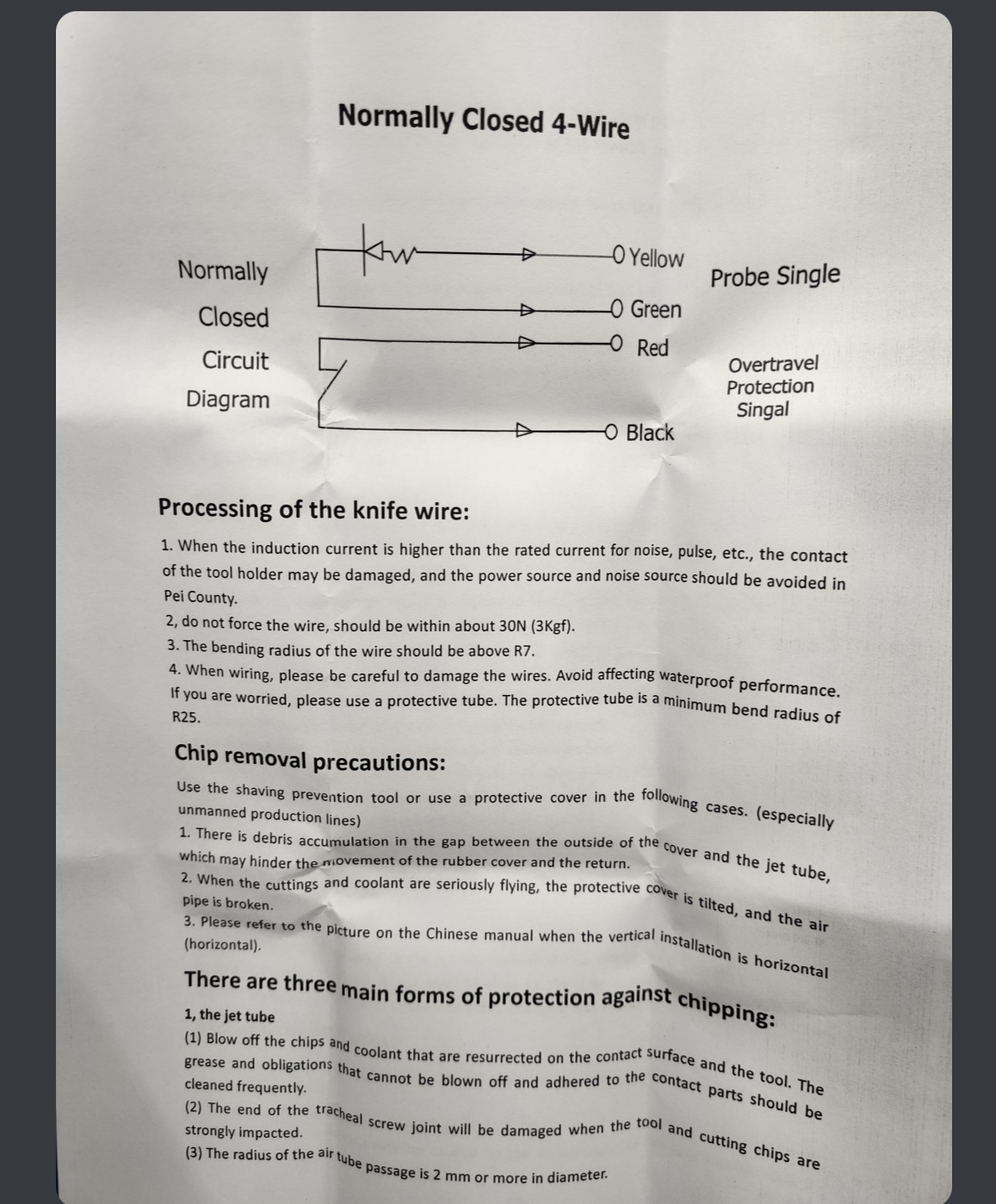

Hello, i need help to connect the tool height probe to the mesa7i96.Thanks
- Posts: 4811
- Thank you received: 2164
09 Sep 2022 10:38 #251543
Replied by Aciera on topic Tool height setter mesa 7i96 wiring
Do you have schematics or can you tell us more about how the wires are supposed to be connected?

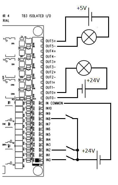

For example:
source of Voltage (+) => Yellow and Red
Green => IN0 7i96
Black => IN1 7i96
IN COMMON 7i96 => source of Voltage (-)
Green => IN0 7i96
Black => IN1 7i96

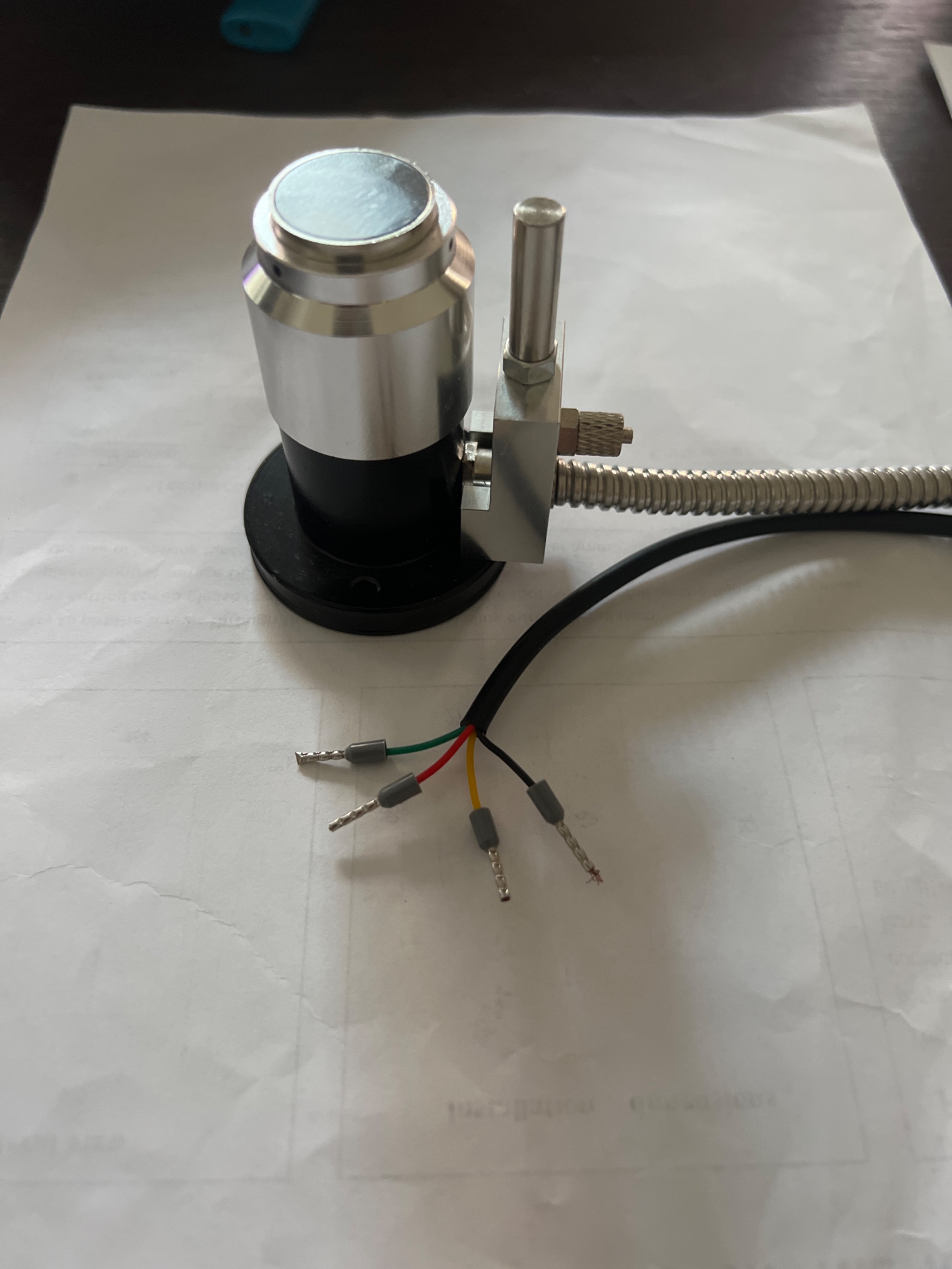

- Tore80
- Posts: 4
07 Oct 2022 12:53 #253687
by Tore80
Replied by Tore80 on topic Tool height setter mesa 7i96 wiring
Many thanks,
Connected yellow and green, now i need to configure in linuxcnc
- zz912
- Posts: 596
- Thank you received: 98
07 Oct 2022 13:23 #253691
by zz912
Replied by zz912 on topic Tool height setter mesa 7i96 wiring
Your next step is checking function in halshow.
