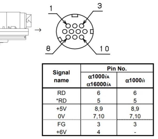

Also.. the 'battery backup ' for the pulsecoders, it looks as if its 6v, i probably should try to hook it to a 5v lithium phone charger battery and see if it works, easily charged and a long life.

The battery backup is external (at least on the older pulsecoders)

So as far as connections go I would connect
RD and *RD to (tx- tx+) and (rx- rx+) 5v to 5v. 0v to 0v #for encoder power.
6v and 0v to a 5v battery phone charger #which in turn is connected to a mains powered phone charger, powered on when the machine is running.
all of these -except the 6v supply can be connected directly to a rj45 connection to my 7i44.

so, pcw, i need to modify the bitfile to include the following modules...
fanucabs.vhd
SSerialTag
this really looks like i need to go talk to my programmer friend...
fanucabs.vhd
SSerialTag
