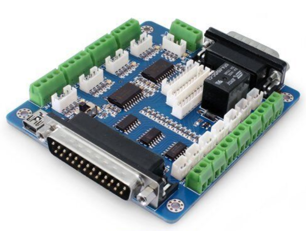

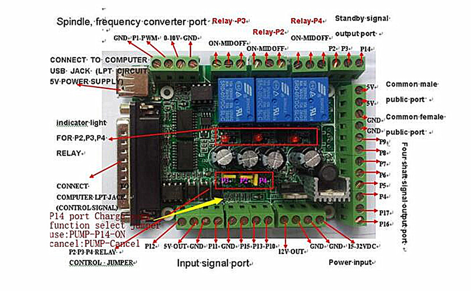

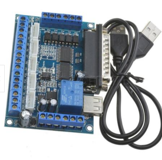

I have done some searching but I can't find any decent info on a particular BOB that I have my eye on. But I'm hoping someone on here may help me out. So I've attached 3 different BOBs I've found on ebay, the one with 3 relays is the one I am interested in most. It seems to have everything I should need, i think. Does anyone have any advice for me? The sellers on ebay have all sold a lot of them, not that that says much. See pics and this link for more.
3 Relay BOB - info in description
The BOB with the hand control option doesn't even appear to have opto couplers, which seems to be a bad idea and I'm not sure about the quality of the cheap BOB. There's thousands of the cheap BOB ranging from $7 - $60 AUD and they all look the same, are they, I don't know??

8 outputs for steppers, 1 for torch, one for spindle and one for laser and PWM, so the board with 3 relays should be better as it does not require rewiring every time you switch. That is all outputs used, so there is no pin left for drive enable, it works without it and since you are getting DM542 they have by default idle current reduction, so that is all good.
Inputs, 3 for THC, so that leaves only 2 for limits/home and float switch, so it does require a bit of hal fidling and editing, but it is doable for sure... although i have to try that.

I give BOB's to others with less experience for free whenever the opportunity presents itself, otherwise i do not use BOB's at all.
Some have no isolation at all, some use buffers, some are properly isolated ... with very slow optocouplers limiting the machine speed.....
A good quality BOB will set you back at least 70$, and you are still limited by the parallel port, so add another 70 and get the Mesa 7i96S.
