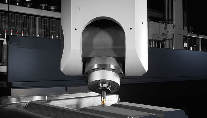

Hello
in a head _head 5 axis machine is there a way to move manually the machine according the A and B axis to drill a hole?
something similar to the Polar move depending from tow axis A and B

Replied by Aciera on topic XYYZBC-str config
Regarding the W-"axis": This is not a physical axis but rather a way to command a coordinated move by the physical xyz axis to move the tool along its rotational axis.
For example if you wanted to drill a hole to a depth of -5 with a drillbit with B and/or C at any angle you would command say G01 W-5 and the drillbit would then move along its axis by -5. Then you could do G0 W10 and the bit would be retracted with a rapid move by 10.
So I don't think you would define a W axis in the INI because that would probably do strange things. (MAybe check in the 5axiskins-sim config)
edit: I think I might be wrong there. So you would define it in the INI so you get a DRO for it.
Note that xyz-bc-trt-kins is for a machine where the tilt and rotation is done by the table. You need a kinematic where the B and C movement is done by the spindle. I think 5axiskins is the one you want.

Seems you are working with version 2.7. I'm less familiar with versions lower than 2.8 but here is a suggestion (make sure to backup your current ini file before making the changes.
The only other file needed would be the "5axiskins" file and I _think_ that is present in version 2.7. Also you seem to have the machine configured as XYZAB which seems odd as with the tilting rotational head you posted the rotation axis would be C. I will need to change your ini to the XYZBC setup because the 5axiskins used in the bridgemill simulation config uses that, so you might have to change the axis letter A to B and B to C in your .hal file.
Try changing/ adding the following lines in the sections indicated:
