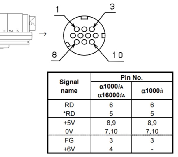

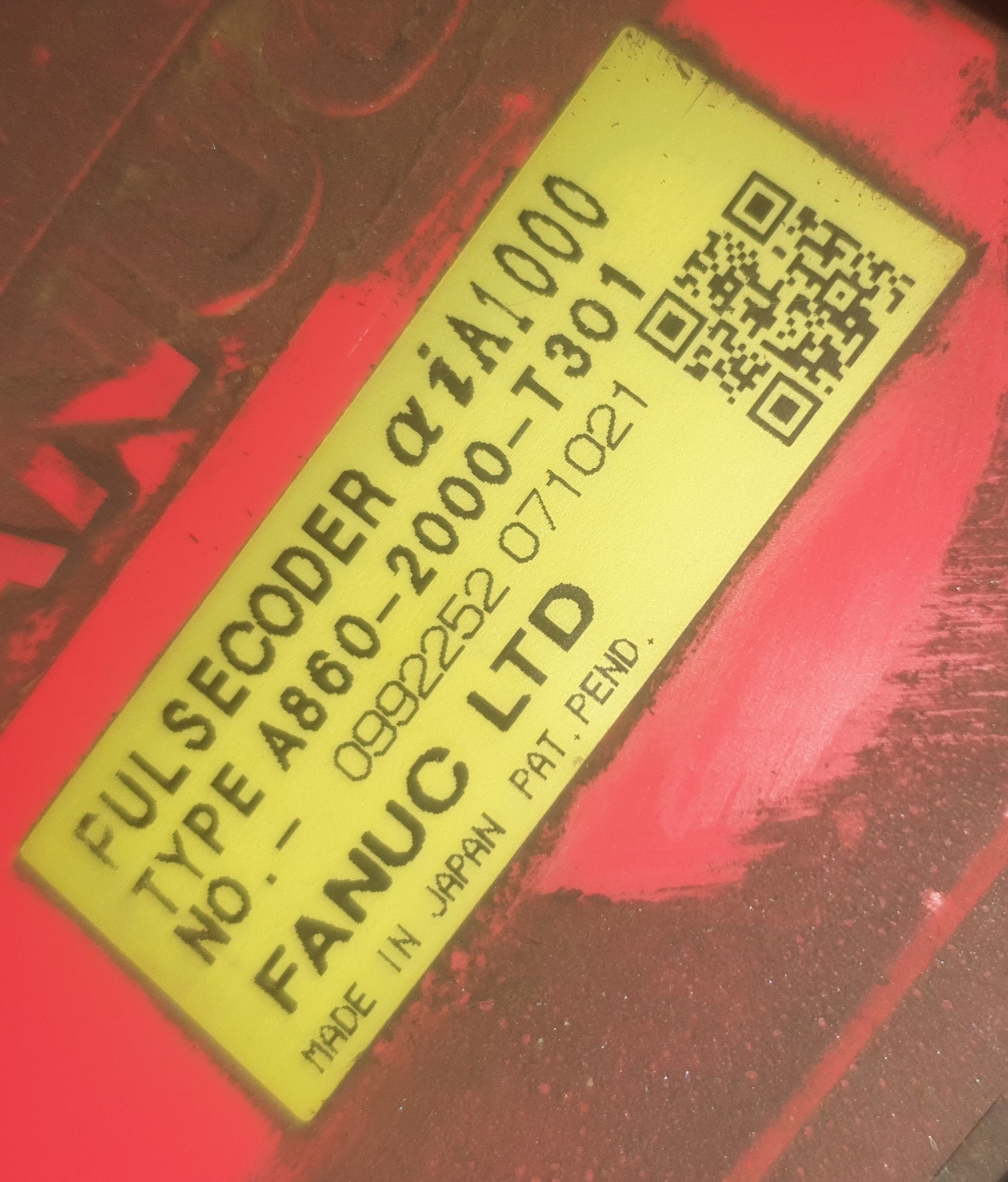

So, now I have firmware, a fanuc a1000ia encoder, and I need a check on its wiring. It only has RD and *RD for data. What do I connect Fabsdata, FabsRqpin, and FabsRqenpin to ? I'm sure I read this somewhere, can't find it anymore.

Unfortunately that's a type II encoder and there is currently no firmware/driver support
for that.
Type I has separate request and data pins (RS422) and a 1.024 MHz baud rate
Type II has shared request and data pins (RS-485) and a 2.048 MHz baud rate

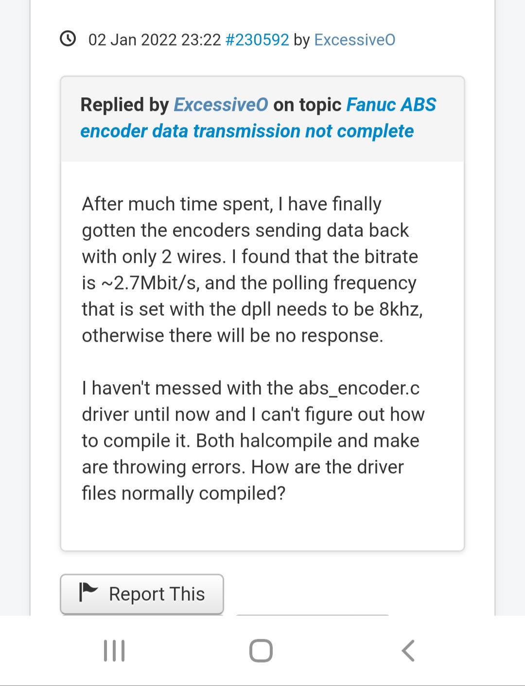

11 Oct 2022 18:12 #253975
by M4MazakUser
Replied by M4MazakUser on topic Fanuc serial encoder wiring
Hey pcw, has this guy had the same issue i had? See attachment
