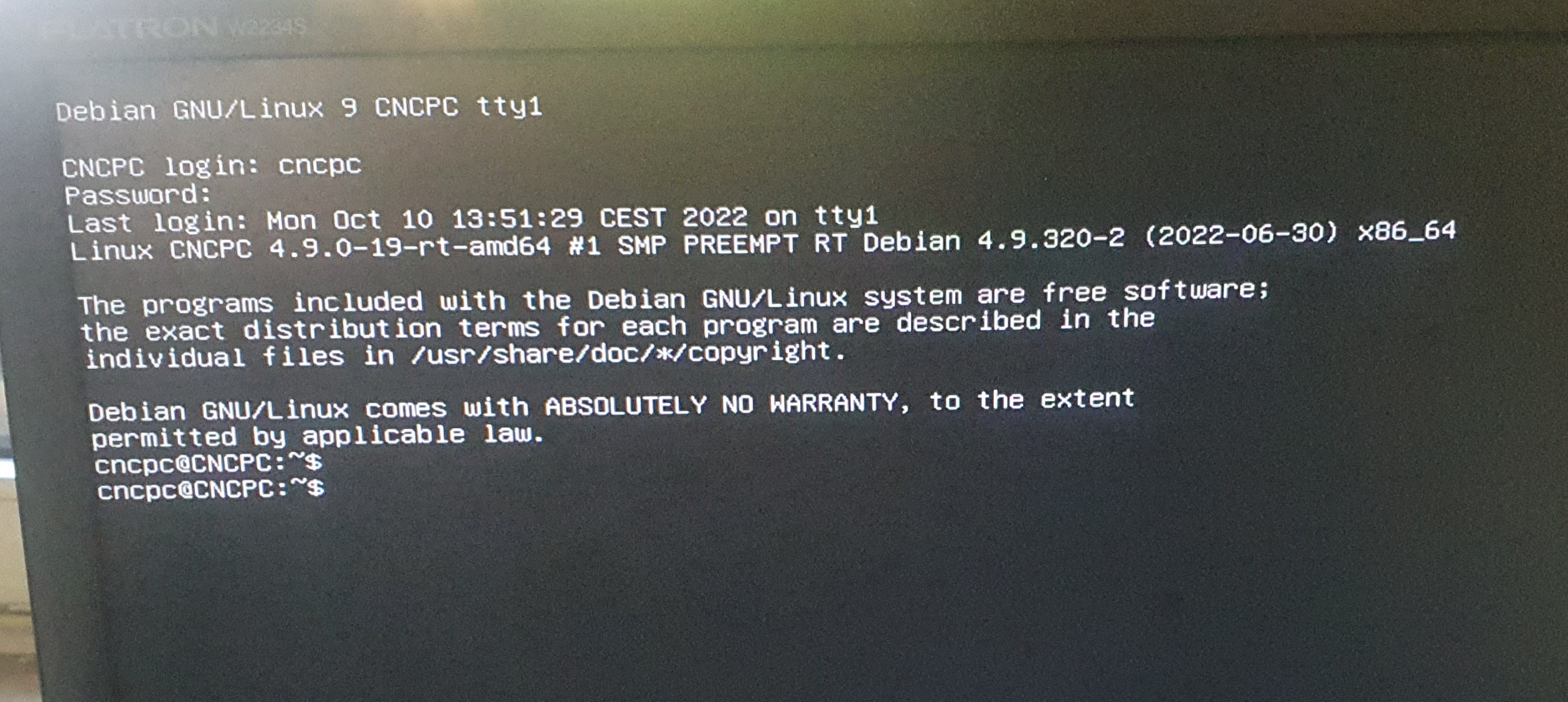

Hello,
i just wanted to do something on my lathe but i am unable to login. The standard login screens does not even show up anymore, but a black login screen.
Please take a look at the picture. I am entering my login details correct, but after clicking enter, nothing happens.
I hope my config is save and i do not loose anything.
Hope someone can help me out. Thanks in advance.

Like tommylight says, try ctrl+alt+F7 to switch to terminal #7 which is often the terminal where the GUI is started. (Some distros start it on terminal #2, so you could try ctrl+alt+F2 as well.)
'startx' is another good suggestion - this should start the graphical environment. You need to be logged in first, as in your picture. Hopefully it will give you some error message that hints to what the problem is.
What led up to this? Did it work before?
Replied by arvidb on topic Strange Black login screen - not possible to login
What you're seeing is a standard text terminal (tty1). This means that for some reason your graphical environment did not start. It's clear from your picture that logging in works just fine though since you get a text prompt (cncpc@CNCPC:~$). You should be able to see your configs by typing 'ls -l linuxcnc/'.Hello,

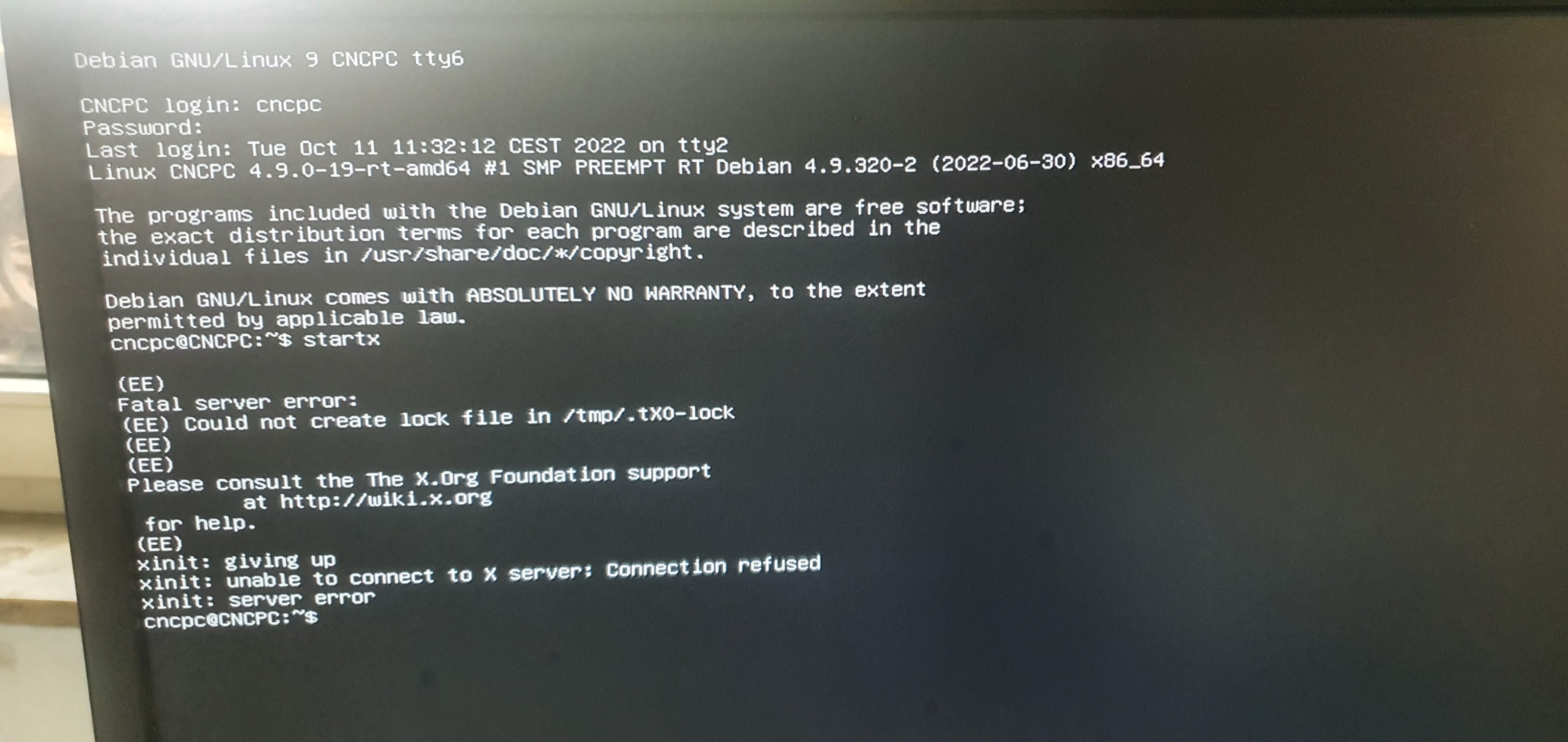

Hi, first of all thanks for your replys.
I tried ctrl alt F7, but F7 is doing nothing, but all other from F1 to F6.
Then i logged in in tty2 and typed startx.
Now i have a blank black screen with a typing sign on top left corner, but its not showing anything else.
My Ethernet was not connected for some time so no updates could happen, thats why i dont understand why i have that problem.

I have tried it now also on tty3 and tty6.
I get what you see on the picture.

Usually that means an x server is already running or something happened to the drive to change permissions, the latter rarely happens.
If you have another PC or an external hdd case, yank out the drive and plug it in the other PC/Laptop, open a file browser, choose the offending drive, navigate to /home/your_user_name/linuxcnc/configs/name_of_your_config and copy that entire folder to a usb or hdd on the good PC.
That way at least you have a backup for the machine so you can do a new install and copy the config back.
You can enable "smart hdd reporting" or simmilar in BIOS, it is pretty good at spotting failing hard drives.
