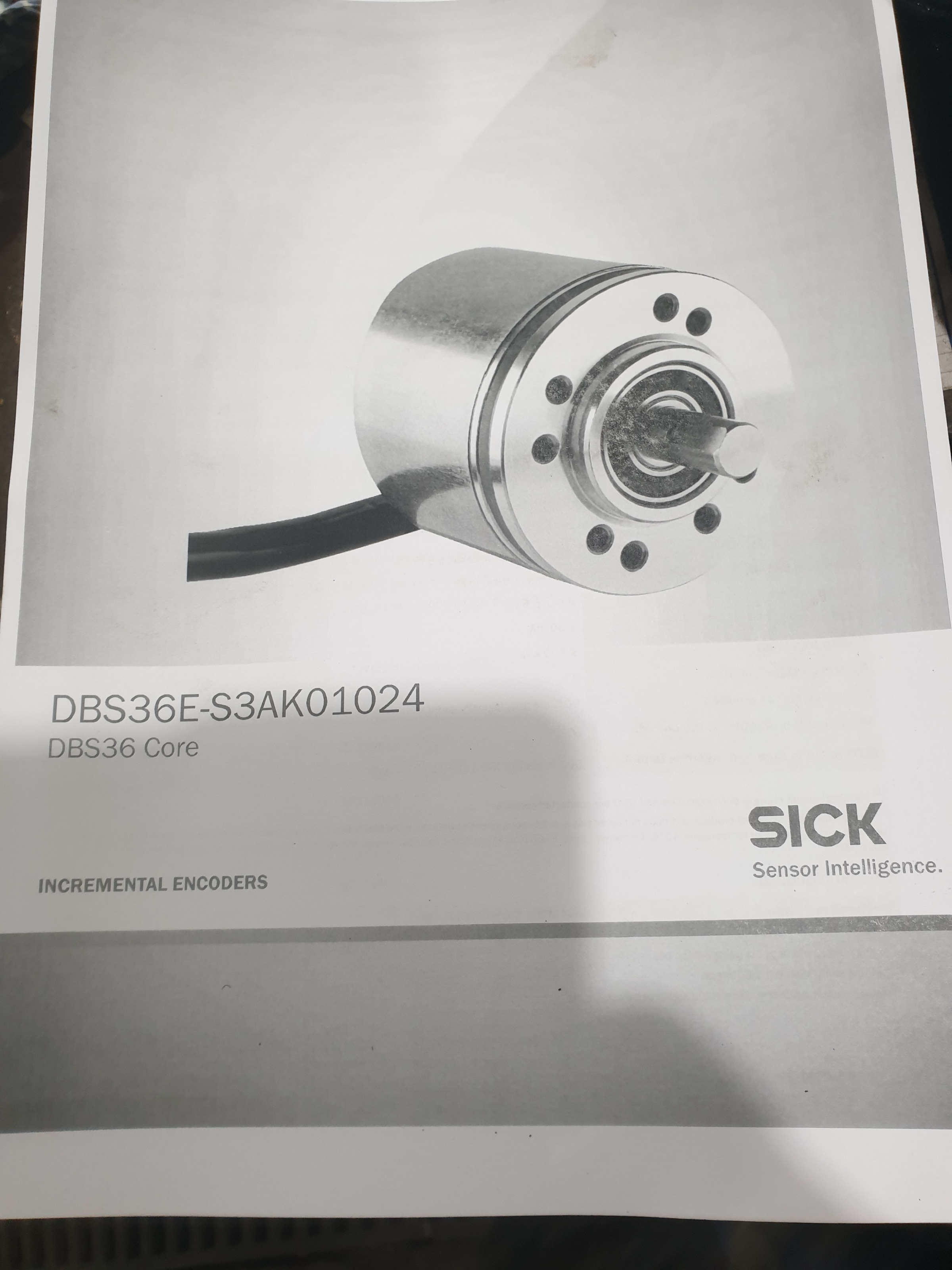

No worries, looking at adapting one of these for feedback, 1024ppr, that really adds up to 4096 quadrature counts, so with a 10mm leadscrew, this would give a 0.002mm resolution.
