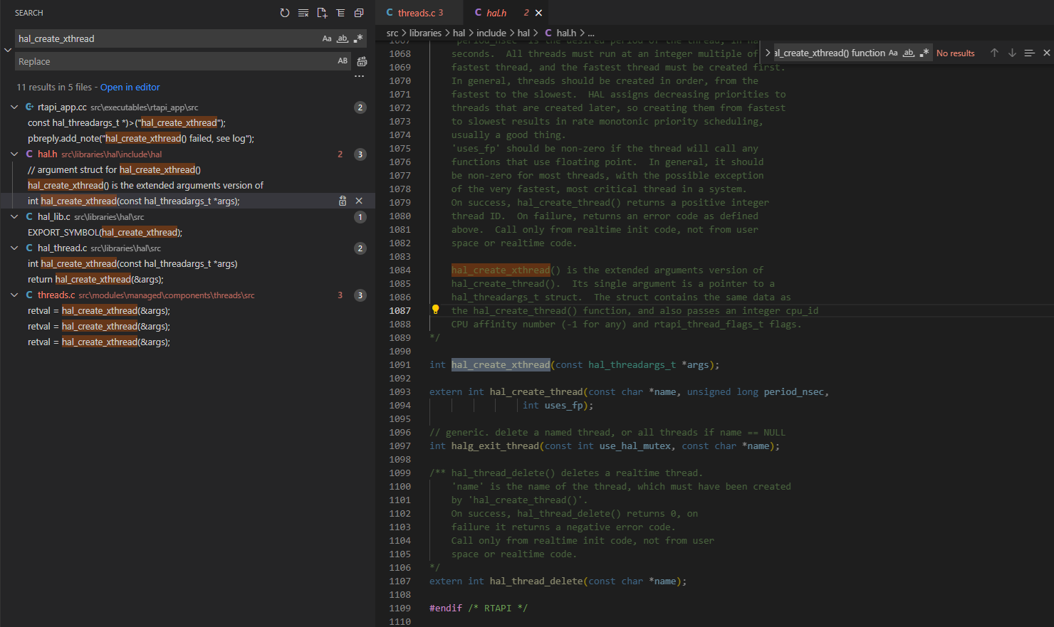

OK. As I understand it, MK is worse in all respects. I looked at git of Machinekit, Machinekit-cnc and Machinekit -hal. There was a mention of the hal_create_xthread() function.Is this the only positive difference from Linuxcnc?But arg cpu_id set default is -1 (use all CPU) in everywhere. Is there any way to set this up in *.ini or *.hal?
