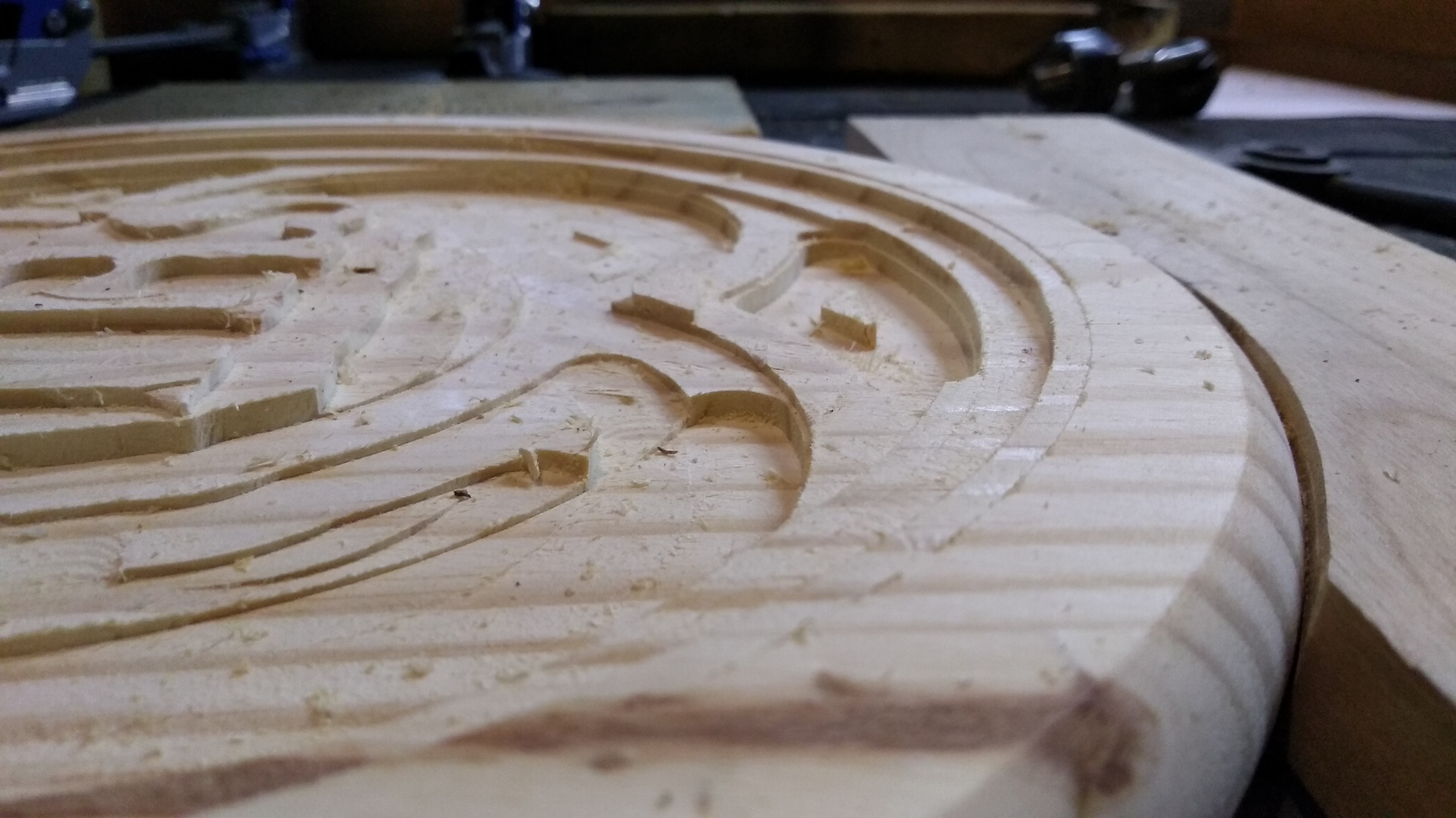

I'm running an open-loop stepper system from a Mesa6i25(5i25-family) card with LinuxCNC 2.8.
Over there I documented a struggle to leap from a software-step system to a Mesa-6i25, hampered by a few serious misunderstandings and misconceptions. However with help from the usual suspects, I persevered and finally returned to a new normal.
I successfully cut two models in wood using my customary setting of 120ipm, but the models were of the "flat" variety: low-relief text on a flat background.
The latest attempt is a deep-dish circular plaque for a wall-hanging, but not that deep: 3/4". I'll attach a picture.
The 1/2"-endmill roughing pass went fine.  For once, caution suggested I do a dry run of the finish pass, which uses a 1mm ball-end and the same, 120ipm, feed which "has always worked before."
After running over the relatively flat southern end of the disk, sounds from the machine indicated it was losing steps, but moments later it stalled, proving it.
My theory is that my MAX_ACCEL settings and STEPLEN as referenced over there are still wrong/too agrees, and that I didn't see it in the rough pass because the performance never approached the problematic zone.
Thank you for mulling this over.
21 Oct 2022 12:28 #254669 by andypugh
If there are many short moves then the system will accellerate/decellerate more often, and possibly on more axes at a time.
You can probably try reducing the max acceleration, but I would also investigate different G64 settings:
linuxcnc.org/docs/stable/html/user/user-concepts.html
21 Oct 2022 22:11 #254733 by rodw
Yes, Andy is on the money. The real world places different stresses on the motor. After an extensive amount of testing, I had some spectacular crashes until I reduced my accelleration.
The other times motors loose steps is when motors get hot and I experienced more spectacular crashes. The Lam drivers some of us use, reduce the current to the drive when at constant velocity to allow the motors to cool to attain higher performance. The motor only works hard when accelerating and descellerating) and the torque at constant velocity might only need to be 20% of that.

22 Oct 2022 23:40 #254809 by clunc
I was messing around with things like:
G64 P0.000001
G64 P0.001 Q0.001
etc. while continuing to search for information about the implications of MAX_ACCELERATION settings in the .ini file.  From G64 I was attempting to learn if a stricter tolerance would force LinuxCNC's trajectory planner (I almost wrote plajectory tranner) to SLOW DOWN in intricate/complex regions.  Not really, was my experience.
However I observed that RELAXING the requirement to P0.01 DID result in the run continuing without "tripping/stumbling" noises, but thereafter noticed with another setting that P0.01 was overly smoothing the details I needed to keep.
That led me back to looking at my ACCELERATION settings in the .ini.
Meanwhile I'd found this observation from @tommylight (for which, again, I am indebted):
Acceleration of 750mm/s/s is ok for lite machines, but for heavy stuff 500 or 350 or 200 might be needed, depending on the moving mass. Although motors might do such accelerations, the load on everything can be so big as to cause premature failures.
In the end, I observed from the test runs that the machine ran more smoothly with MAX_ACCELERATION reduced in the .ini file from '90' (horrors!) to 20, with a default of 10 in/s/s.  (I tried to imagine 90 in/s/s, and it made me jittery.)  With these values in my .ini:
[TRAJ]
DEFAULT_LINEAR_ACCEL = 10
MAX_LINEAR_ACCEL = 20
# down from 90/120
[AXIS_X]
MAX_ACCELERATION = 20
# down from 90
[JOINT_0]
STEPGEN_MAXACCEL = 25
# down from 90/112.25
# and same for [AXIS_Y|Z] and [JOINT_1|2]
operation is much more peaceable.
I'm confident now I'll be able to do the finish cut.
