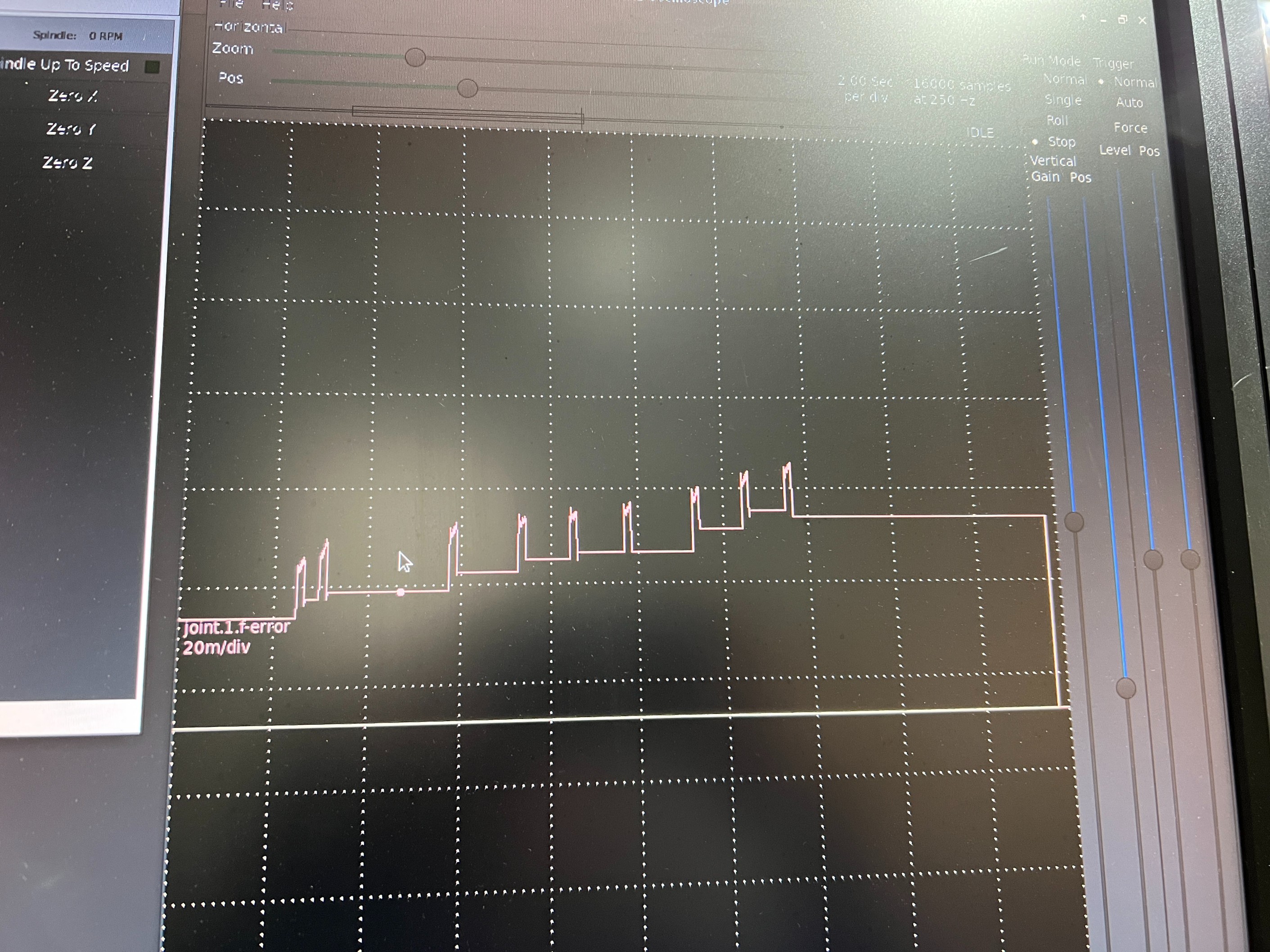

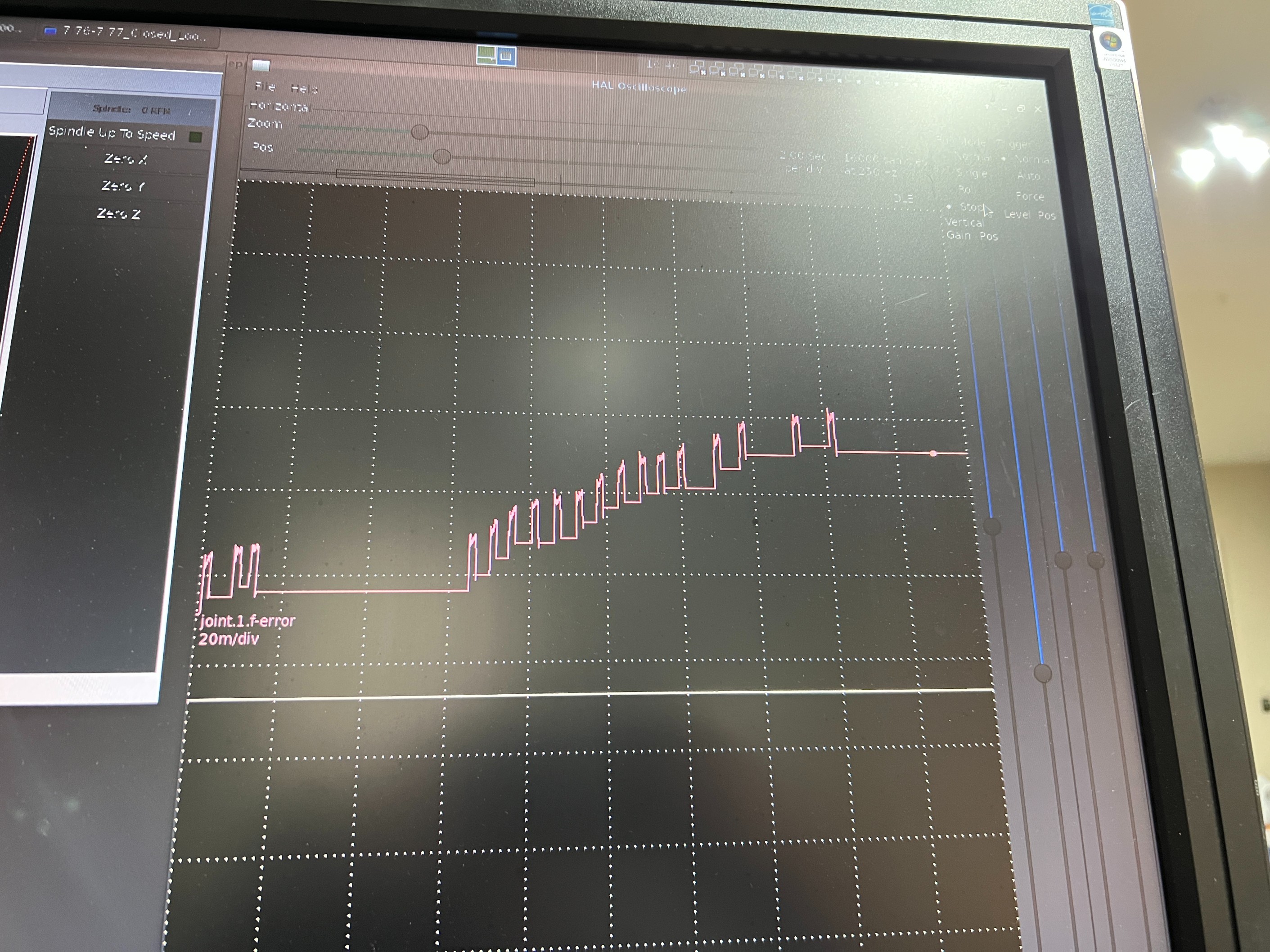

Problem: After every move there is an error in the position of the servo. That error is also there when using a closed loop stepper. The error increment changes based on the step scale. Most of the time the error seems to increment by 1 step, however sometimes there is 2 steps worth of error, or rarely no error between position moves and most rarely 1 or 2 times the error went in the opposite direction when testing this with the closed loop stepper I had on hand.
This loss of a step or 2 each position move causes quite a buildup of error leading to problems.
The attached ferror plots represent the error in each 1mm increment as I have no PID terms and FF1 = 1 (no feedback).

For open loop stepper systems, P must be 1000 for a servo period of 1000000, the rest is 0 except FF0=1.
First set up open loop by setting the above values and having feedback in LinuxCNC set from stepgen.
You can do this with encoders wired, so no need to mess with wiring.
After you get that working properly, change the feedback to encoders, check functionality, and if required proceed to tuning as a servo system.

I am amazed that this is working even as well as it is.
Add a P-gain of 1000 (as suggested above) and it should all work a lot better.
With only FF1 you are running purely in velocity control mode with no feedback or PID correction.

This worked except with FF1 = 1 instead of FF0 = 1 (I think because I am in velocity mode instead of position mode?). Thank you so much for pointing this out, I didnt realize these specific PID terms were necessary when using stepgen open loop control.
