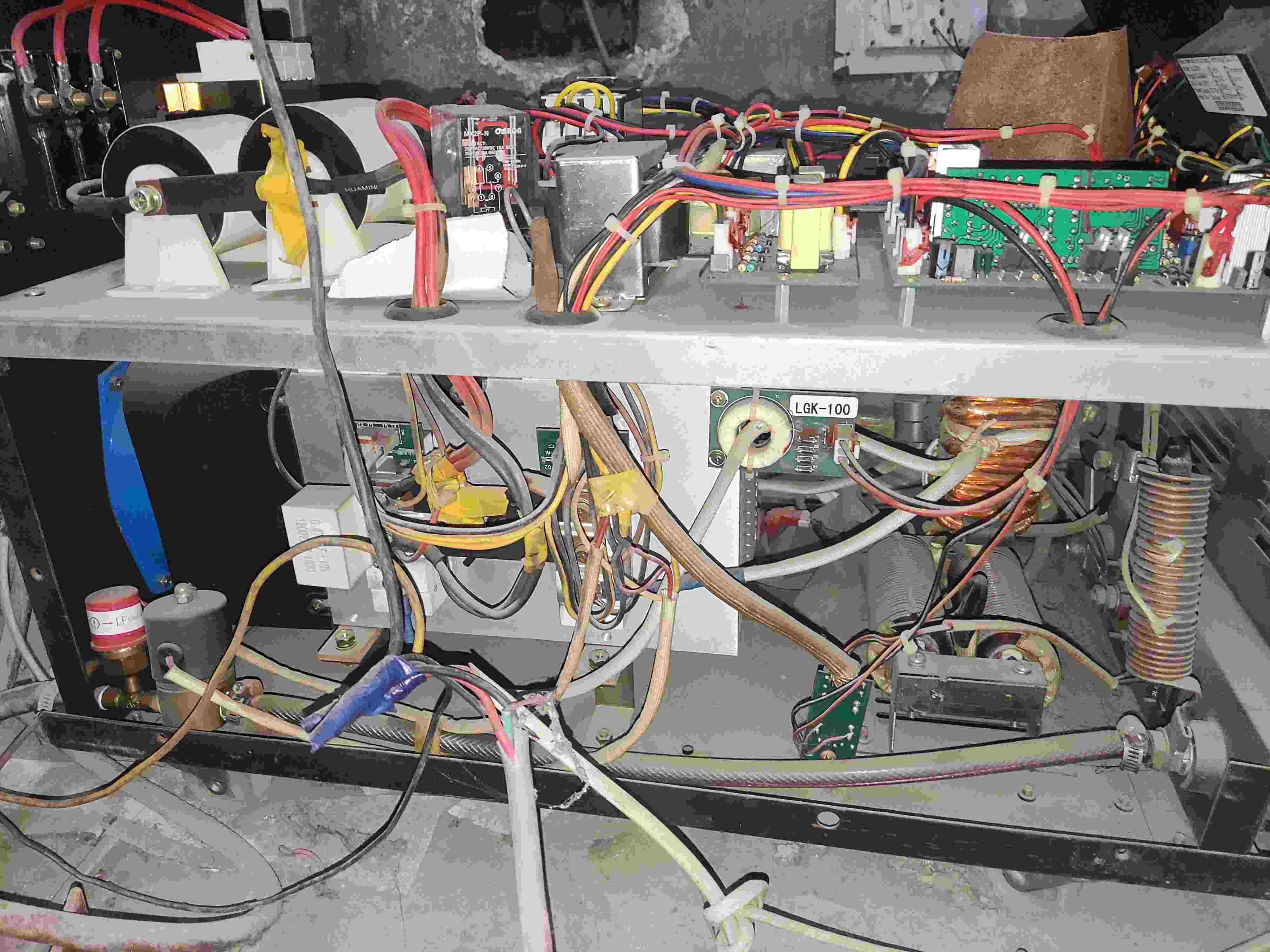

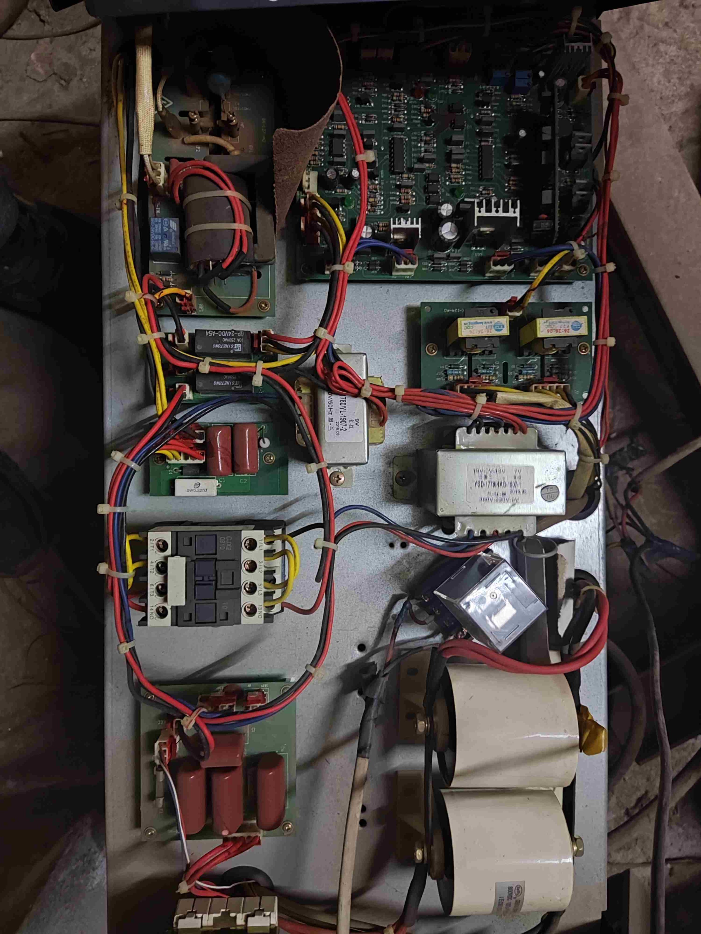

Sir,
I have MESA THCAD -10 and mesa 7i96 and I want use this MESA THCAD -10 connected High frequency start plasma machine and this plasma cutter not have a divider board so please tell which resistor value required THCAD -10 connected to plasma cutter and also tell how to connect mesa 7i96 to thcad-10.

A 2.4 Meg series resistor added to the THCAD-10's negative input
will give you a 250V full scale range.
BUT: The voltage sense point must be taken from the plasma supply
before the HF start circuit. Before you connect ANYTHING Wait for some
warnings and advice from "tommylight"
The THCAD-10 normally would connect to the the 7I96's encoder input:
7I96 THCAD
5V 5V
GND GND
QA+ FO+
QA- FO-
7I96 THCAD
5V 5V
GND GND
QA+ FO+
QA- FO-

02 Nov 2022 00:32 #255723
Replied by tommylight on topic Mesa THCAD-10
Better pictures, firs and second are really bad, i can not make out what goes where.
