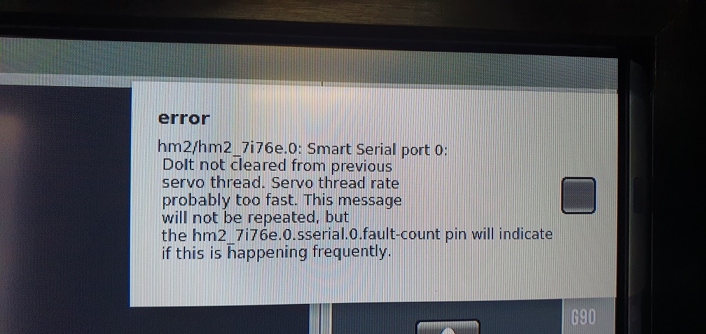

Servo thread rate too fast
- CNC_ANDI
- Posts: 233
- Thank you received: 31
11 Nov 2022 12:30 #256423
by CNC_ANDI
Servo thread rate too fast was created by CNC_ANDI

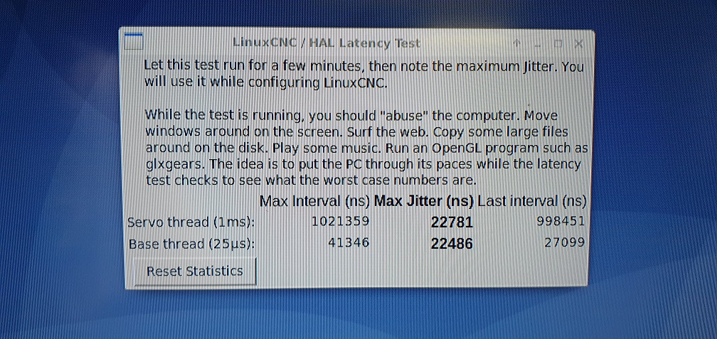

11 Nov 2022 12:42 #256425
Replied by tommylight on topic Servo thread rate too fast
Beim BIOS,
-disable hyperthreading
-disable C states
-disable everything with power saving
-disable turbo
-disable speed step
etc.
-disable C states
-disable turbo
-disable speed step
etc.

Hello thanks,
but always was disabled in Bios, now changes
i´ve tried isolcpus=1,2,3 too, makes al litte bit of change

Also if your host PC has an Intel Ethernet chip, you must disable IRQ coalescing
(man hm2_eth)
What host hardware do you have and which OS?
(uname -a)
(man hm2_eth)
(uname -a)

hello, the uname -a file is in my first post
i dont know what you mean with (man hm2_eth)
how can i disable IRQ coalescing?
it´s a intel i5 quadcore with 16gb of ram and ssd harddrive

OK so you have a Intel MAC which needs to have IRQ coalescing disabled
temporarily, you can try
sudo ethtool -C [ethernet_device_name] rx-usecs 0

He means "type 'man hm2_eth'" at the command line to view the hm2_eth manual pages.i dont know what you mean with (man hm2_eth)
Alternatively, follow this link: linuxcnc.org/docs/stable/html/man/man9/hm2_eth.9.html

ok thanks i have test it and the latency is much better
max 12000 jitter
i will test it few times
max 12000 jitter
