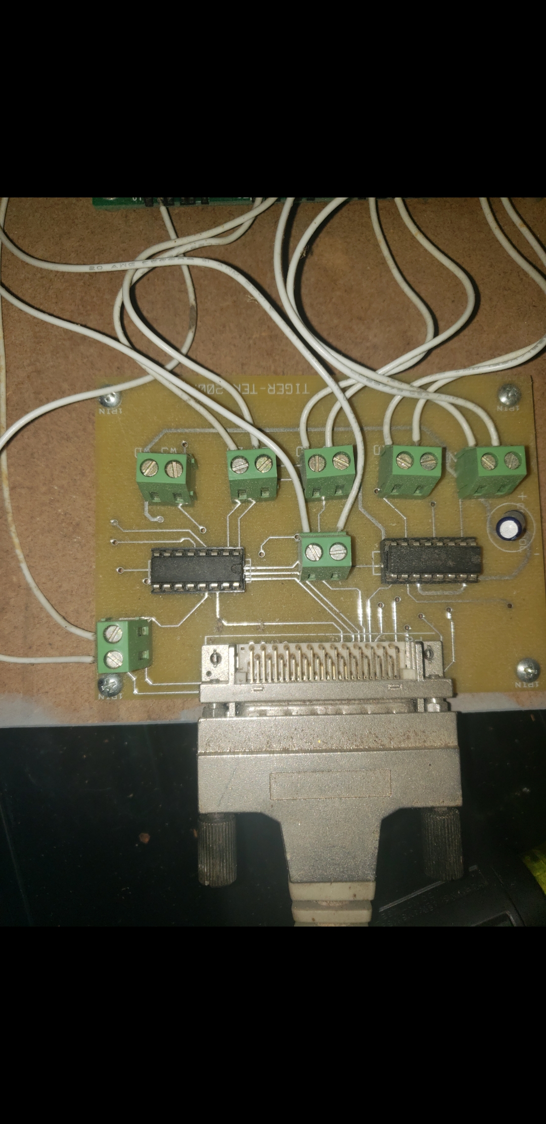

some pics of boards

I would hazard a guess that the beige board is just a couple of ULN2003 chips?

thanks everyone for all the input and offering your time and expertise. very warm welcome to a newbie. ill dig in with the base I have gotten and see what success I may have.
and as for the board just cheap insurance against emf? or open circuit failure between the drivers and pc?
I could just buy a little adapter and go with that but id like to try and get my head around hal and some of what linuxcnc has to offer if nothing else but to learn a little something if possible.
again thanks to everyone who has chimed in much appreciated id hate to waste your time too much without trying to apply some of what has been suggested so far and put some effort in before asking much more of you guys.

it has drives for each axis ive been wondering why the redundancy of so many boards i assumed that the lower board was doing the step dir and thats why I had gotten good speeds with not great latency. I've seen setups with the pmdx alone and the though crossed my mind that I had someone's half solution to a dsp control changed over to a mach3 control. its doing ok so far .ill learn what I like what I dont, and ill have something to base my changes and my purchases off of when I get to that point. its really my starting point in cnc other than just operating one.
its been ridiculous finding info on a build like this tho cause not only is every part outdated. but it seems the sum of the parts were bandaids and reworked more than planned and thought out. but I dont really have enough knowledge to make statements like that.

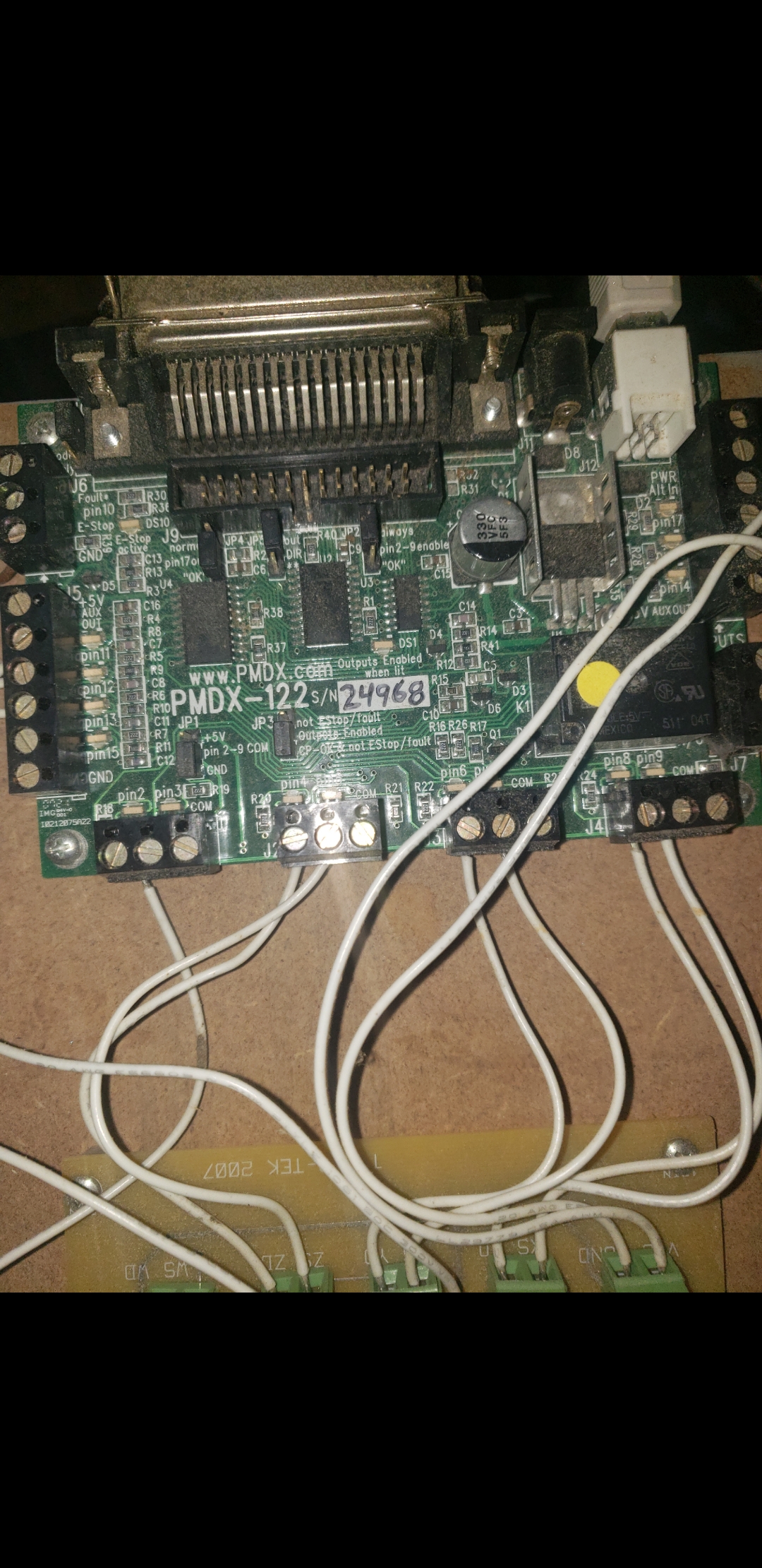

The PC (LCNC) is doing step & direction outputs
The PMDX is all you need. It's quite possible - likely even - that the PMDX was added later for some reason.
PMDX is a US-based company making pretty high-quality components. Weird pin naming, confusing user manuals, and they're locked in to Mach4...but high-quality stuff. The fact that they used 2mhz optocouplers 15 years ago speaks volumes.
Not the kind of thing a low-cost overseas OEM would use... but exactly the sort of thing some owner would put in after the fact. And remember - as old as that router is, there weren't a ton of options in the mid 2000's for hobby-ish breakout boards and motion control.
So you've got drives. Just hook the PMDX up to the PC, the drives to the PMDX, and you're in business. Like starting from scratch, but free.

I am guilty of misuse of terms often i know. but im of the understanding that the steps and direction come from linuxcnc but I was under the impression that the control board was doing the heavy lifting and making the pulses and that was how I was running decent with 30,000/ 35000 latency numbers. I was told and have read that the mesa cards do the same thing only at a multiple of like 50 or more than the hardware im running.
if im way off base please by all means correct me. I was aware I could run just the pmdx 122. but was under the impression that my control board was a benefit ( however outdated) .
your saying that I can lose the two other boards and im not gonna suffer any loses for it?
I wondered why the redundancy and assumed the pmdx 122 was simply better suited to replace the dsp handle and the loading of g code from a USB stick with a pc and mach3 . and thats where the concept that the lower control board was doing the heavy lifting came from was the fact that it used to do everything except translate the gcode and send the signals ,which the dsp handset did.
im new to all of this and maybe im guilty of too many assumptions, I get the concept of running on the pmdx alone but your saying I can do so without taking a hit on speed and latency? preforming the same ?
possibly an improvement maybe?
