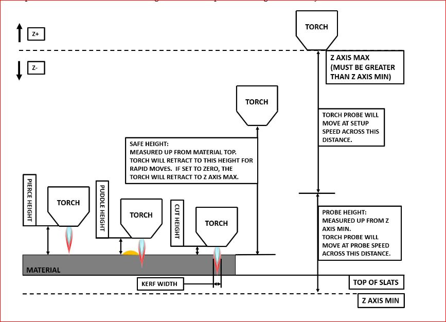

I am in the stages of configuring a new table with LinuxCNC QPLasmaC, and just got my Ohmic sensor working ( my own version module).
When I tested it with the button it works as I would expect, and after a short delay it starts moving up. I get an statement that I don't understand that is. Safe transverse height has been reduced. On my other table when doing a cut the software controls the movement of the Z for the touch off and then pierce height movement. When I had this controller hooked to my other table I did a test cut and noticed an odd movement of the torch before each touch off. The torch moved to the next start location and it would move up almost to the limit switch before doing the touch off (I used a floating head switch but assume it would be the same with the Ohmic sensor). I think these 2 movements are related so I am looking for an answer, why the message, and how do I reduce the height movement before the start of the cutting operation. Attached video show the movement I talk about above.

You possibly have Safe Height set lower than Probe Height, it should normally be the other way around or the same height.
Safe traverse error means that the top of the material was detected and the distance between the top of the material and the maximum Z travel is less than the Safe Height.
Safe Height is the height above the top of the material that the Z axis moves to between cuts.
Probe Height is the height above the Z minimum limit that the Z axis moves to at Setup Speed, then the probe begins at Probe Speed.

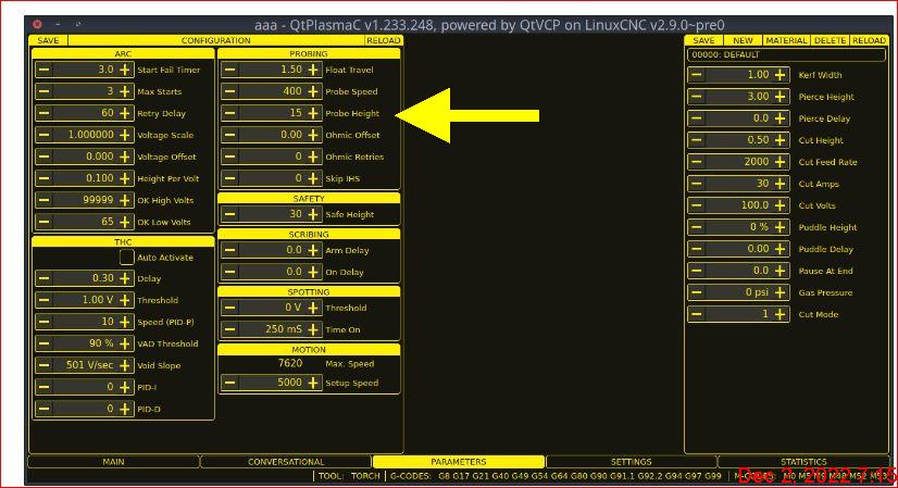

Is this where I change the height setting, see image

Yes, that is the correct place.
