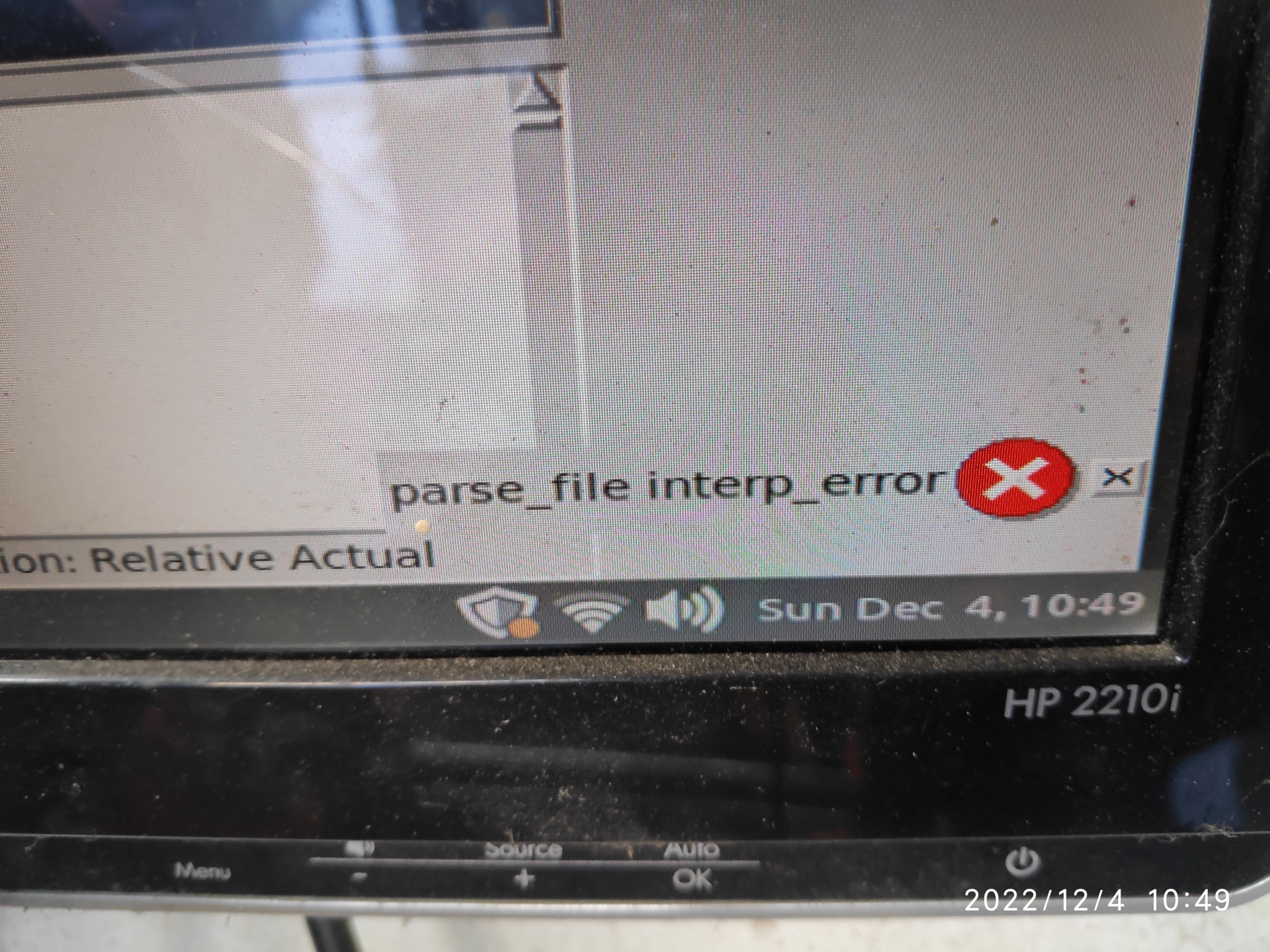

Hello,
When loading large ngc file (240 MB) linux cnc crash.
If i try loading the file disabling axis preview it say: "parse_file interp_error" and don't load the file.
Program file: marcogaspar.net/linuxcnc/2002.ngc

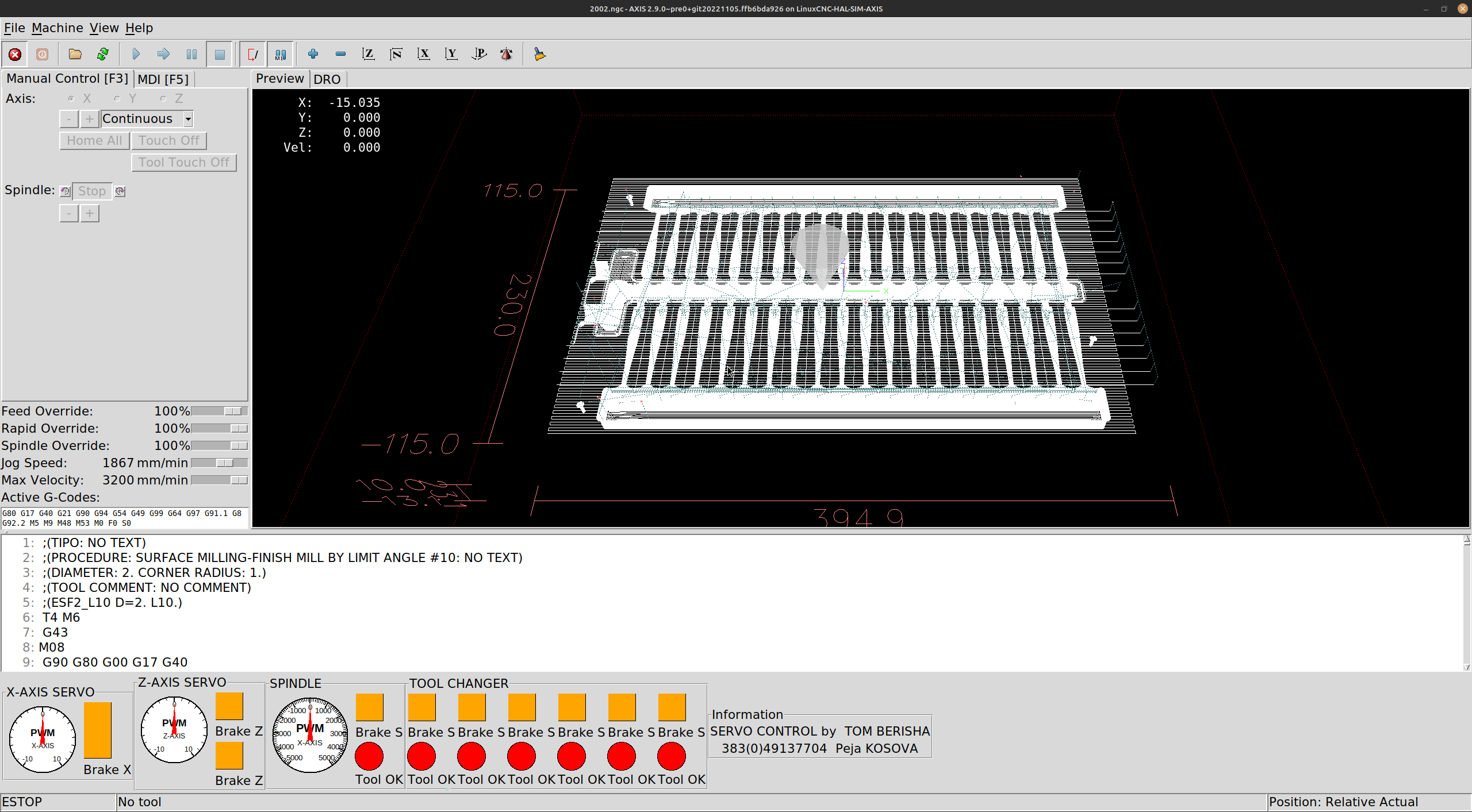

I tried cutting the file down until it would open, but the limit seemed to be somewhere below 1 million lines (your code has 7.8 million lines)
However, looking in the kernel log I see:
How much memory does your PC have? It is possible that more might help.
[130829.056946] Out of memory: Kill process 2157 (axis) score 479 or sacrifice child
[130829.056960] Killed process 2157 (axis) total-vm:2229844kB, anon-rss:1887644kB, file-rss:0kB, shmem-rss:56kB
[130829.104866] oom_reaper: reaped process 2157 (axis), now anon-rss:0kB, file-rss:1040kB, shmem-rss:56kBHow much memory does your PC have? It is possible that more might help.

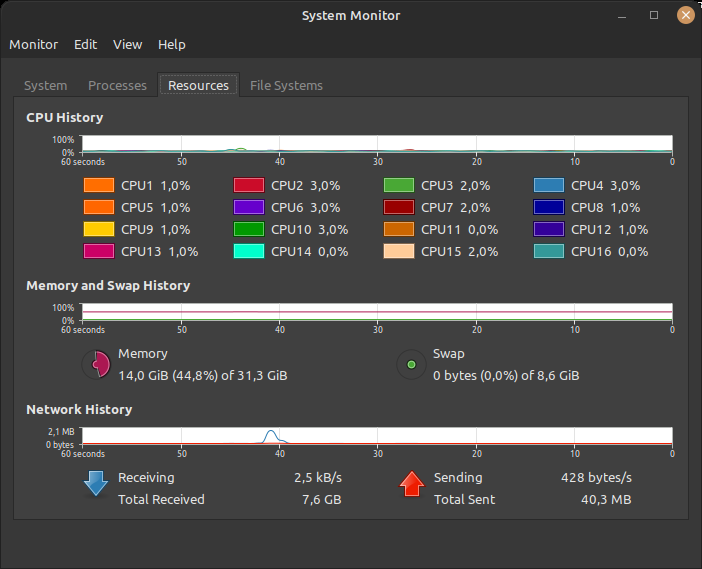

I can open it on my main PC, also GUI is very responsive despite the graphic card being at 90% load, i can zoom, move, pan and tilt, until it locks after about 3 minutes of playing around.
It does not lock if not messed with much, a bit of messing seems OK.
When it does lock, some processes have to be killed, ending some does not work.
Notice the screenshot with CPU/Memory usage, i watched the memory climb from 4.8 to 14GB while this was loading, took about 80 seconds.

I just doubled the memory of the VM I was testing in and managed to get the code to run (by turning off the preview at line 1 milllion)
At that point Axis was using 4GB of memory.
So it looks like if you increase system memory (maybe to 8GB?) and turn off the Axis preview then the code will run. If you already have that much memory then maybe look at closing other software (is the CAM software running on the same PC?)
But it might also be worth looking at changing the postprocessor settings to shrink the file size. The gode mainly contains of moves of around 50 microns in length.
