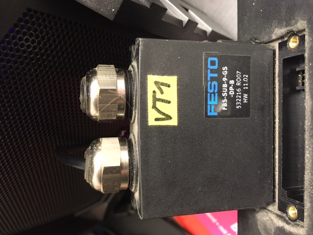

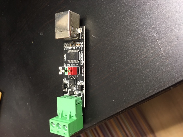

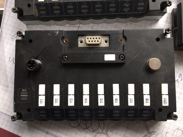

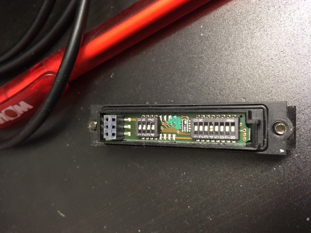

So now that I have my components together I have started testing.
As expected, there are of course schierigkeiten, which it is now to eliminate!
so I have this control unit: CPV14 GE DIO1-8
165811 R007
HW 2.11.00
SW 14.01.99
In addition the connector FSB-SUB-9-GS-DP-B
532216 R007
and a USB to RS485 TTL Serial
After I have wired and connected everything I have the following situation:
- at the valve island the power LED is permanently green
- the red BUS LED flashes every second!
- the DEMO of LCNC starts and I get the following in the terminal:

The settings in the connector are as follows:
My first question would be:
- do I need another gse file?
165811 R007
HW 2.11.00
SW 14.01.99
532216 R007

I can answer the question myself
Yes I need a new gse file named:
VI1000C9.GSE

I have now inserted the gse file into the Profibus.conf unfortunately no change of the described state
On the converter the RX LED flashes but the TX LED does nothing.
It looks like there is no connection to the module!
I have the two data lines on the module labeled A and B and connected to the converter with A and P so:
A --> A
B --> P
is that correct?

Hard to say from afar but my first guess would be a misconfiguration of the RS485 adapter. Would help if you had a scope to see if it's actually putting out the data to the line.

Now I have changed the converter and now I get the following output in the terminal:Nevertheless, there is still something wrong with the connection!
PHY-serial: TX 10 08 02 49 53 16
PHY-serial: RX 10 08 02 49 53 16
PHY-serial: RX 10 08 02 49 53 16Please Log in or Create an account to join the conversation.
