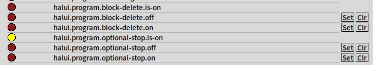

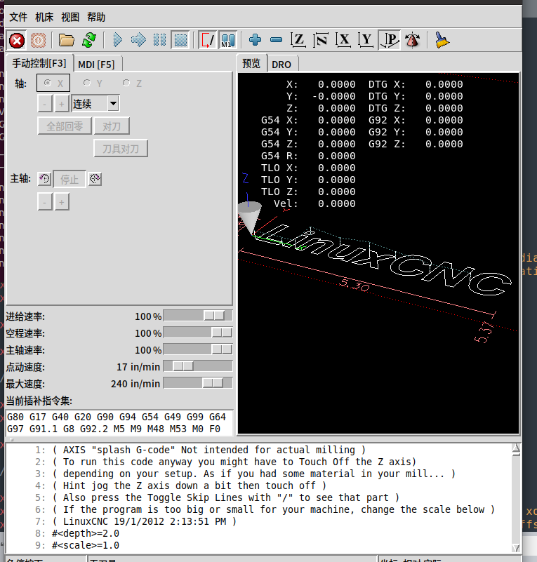

Hey, I want to change the initial states of optianal-stop and block-delect when I open the Linuxcnc. But I don't know how to change. Please help me! Now the state is like piture 1, and I want to change the initial state to the picture 2. I have tried to write something in the .ini file but falied. Thank you!

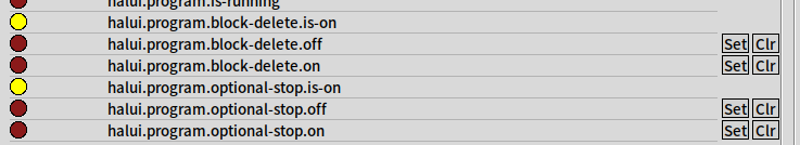

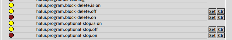

I add these to my hal.
setp halui.program.block-delete.off 1
setp halui.program.block-delete.on 0
setp halui.program.optional-stop.off 1
setp halui.program.optional-stop.on 0
But it doesn't work.
The halshow show as the picture.
The result should be that the halui.program.block-delete.is-on FALSE and halui.program.optional-stop.is-on FALSE. It doesn't work as we wish.
