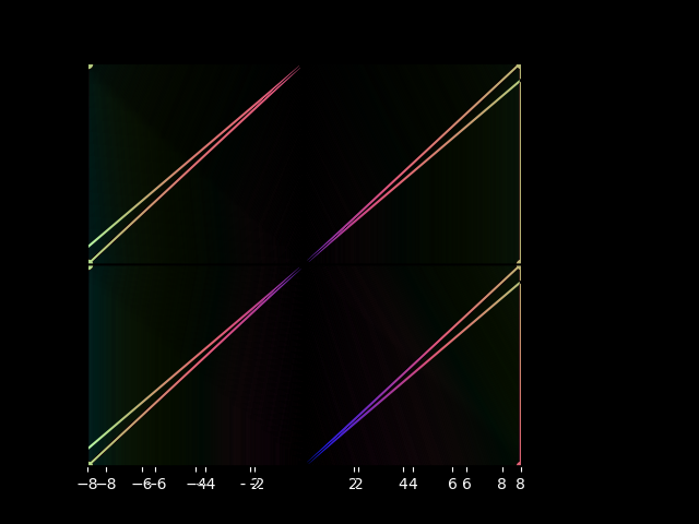

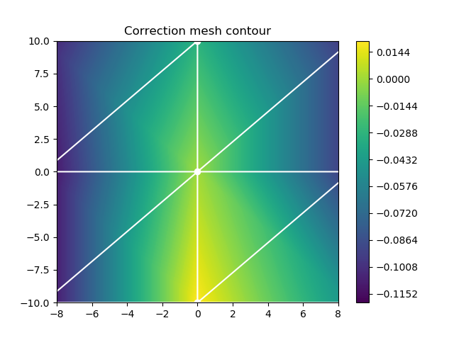

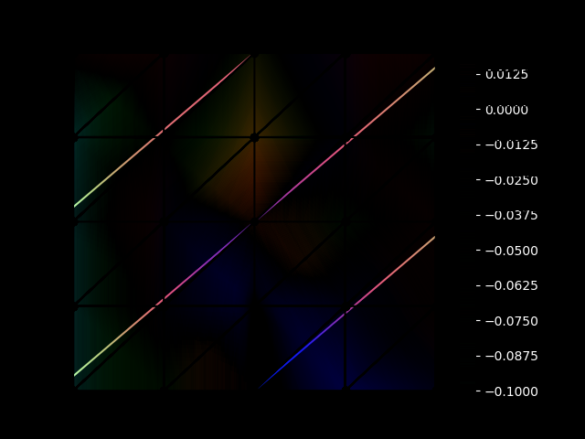

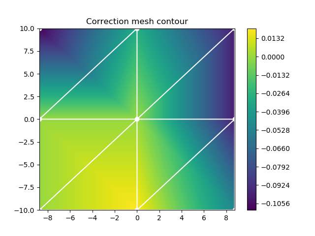

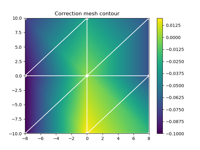

05 Jan 2023 18:12 #261014
by clunc
I visualized the results of each with:
./probe2stl < probe-results.txt | ./stlvis -b -8,-10,8,10
so that both were scaled to the same x-axis, and saved the results off to separate .png files for import into GIMP, the graphics editor.
Inside GIMP I subtracted one image from the other which, surprising to me, showed virtually no difference in the surfaces matched. Even the color legend matched perfectly. I sense a slight difference along the left and right edges. These are the first three figures.
I also measured Z values on a 5x5 grid x={-8,-4,0,4,8} and y={-10,-5,0,5,10} and generated its plot and diff, attached as the last two figures. The differences between the 3x3 grid and the 5x5 are more pronounced, as could probably be predicted from the difference in granularity.
Replied by clunc on topic ScottA's Compensation Component for Uneven Table (was "Probekins"?)
To try to address this, I went back and re-took Z-measurements at top-of stock on a 3x3 matrix: x={-8,0, 8}, y={-10,0, 10} to compare with the original, measured on x={-8.75,0, 8.75}, y={-10,0, 10}.Also, I noticed that 'compensation.py' finds the extrema of the extents (min-max X-Y) but then truncates them to integers before fitting a surface to the gridpoints. I don't know what if any effect this would have on the effect, but I point it out. In my case, 8.75 inches gets rounded to 8, a fairly substantial change. I'll take my next measurements only on integer bounds.
