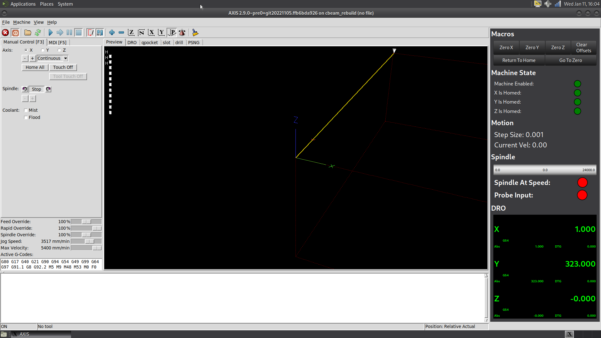

I ran memtest86+ and memory passed. I upgraded all the software... no LinuxCNC will run.

Interestingly the PC in the shop with the exact same hardware and OS and LinuxCNC runs fine... I suspect something is broken on this PC.

I've noticed something similar on my (non-rt) test setup, this occurs fairly regularly but not at startup. Sometimes the backplot stops working though.

Also it seems that the error only appears when the axis backplot is visible. Vismach doesn't seem to cause any errors.
