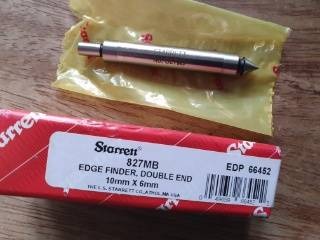

I've slightly 'solved' the probing issue as this arrived in the post this morning:
(I couldn't get on with the wiggler) but after all the effort I've put into the Renishaw mount (and have to admit being quite pleased with the result!) I really would like to get the Probe Screen working...

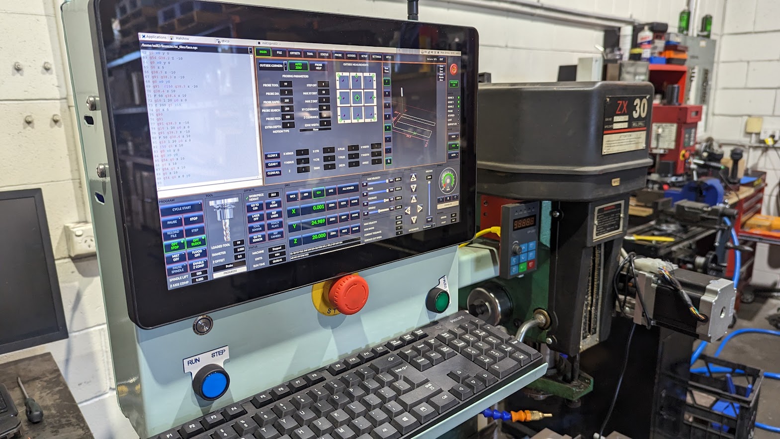

Yes, I had a 15.6" Asus 1536 x 768. I could not find any GUI that scaled nice.
I ended up buying an industrial 15.6 inch 1080p monitor from greentouch.
It has a full metal case so much more robust than the crappy Asus.
They had lots of nicer options but had to use one with a Bezel as the flat mount ones were too big for my enclosure.

Your monitor is great.
Xfce top bar is automatically hidden ? because unless the bottom of qtdragon_hd is invisible, the status bar should also be visible.

Thanks, I made it hide the top panel. I think I will leave that until I finish fixing everything up and I don't really need to update anything.
Its a bit annoying otherwise.
I forgot I had found a regression in Chris's code which required editing a hal file. I will report it The hal type for the spindle connection should be bit, not u32. What was working for me broke on the last update.
