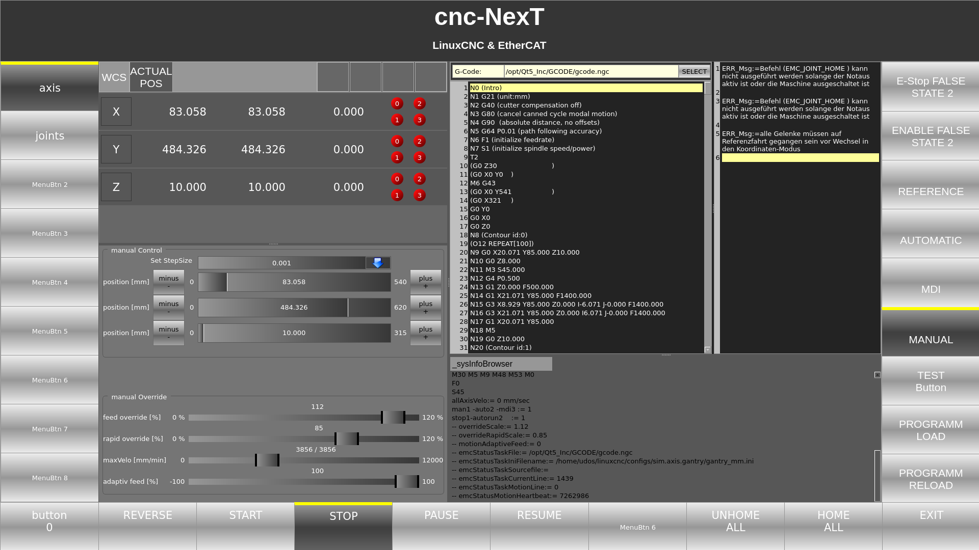

- Grotius
- Posts: 2419
- Thank you received: 2349
19 Feb 2023 20:56 #264830
by Grotius
Replied by Grotius on topic NML c++ read nml Error and Messages

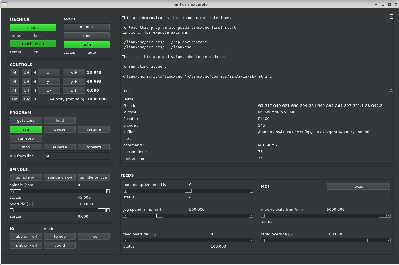

- udoS
- Posts: 216
- Thank you received: 25
20 Feb 2023 07:58 - 20 Feb 2023 09:32 #264854
by udoS
Replied by udoS on topic NML c++ read nml Error and Messages
@Grotius
If it means something to you then you have my compliments for this;
It's a pity that it is not more prominent; Nice piece of work;
And sorry, but I will certainly use it.
What I didn't find is the ERROR channel handling, but I got that figured out by now;
The problem was to be the first in line;
