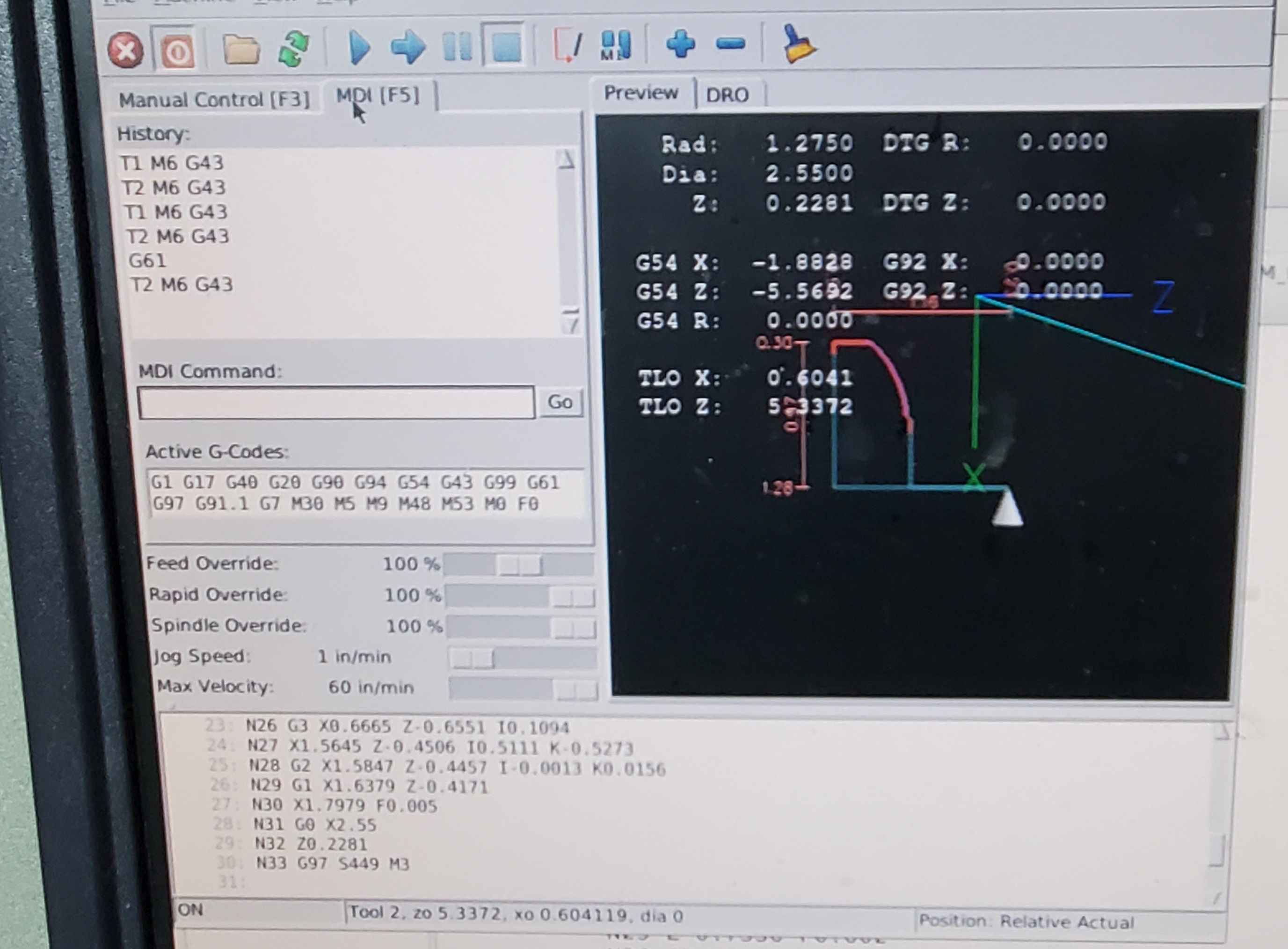

I took a slow motion video of the X,Z coordinates on the preview tab while running the program. I made a X,Z point cloud from the video and applied a best fit arc in CAD. The arc radius measured .734". This with a .016" insert radius should yield .750". I zipped and attached point cloud data with both G64 and G61 evoked.
Are the coordinates displayed in linuxcnc a real time representation of the TCP?
Thanks!
Thanks!

Maybe try repeating the procedure with actual / feedback position displayed?
Are you 100% sure that your Z scaling is correct? (I imagine that if it wasn't you would have noticed before now) but I have been caught out once by a 5tpi screw that I thought was 5mm pitch.
(Though I just tried dividing the Z positions by 1.016 in the sketch, and it made the radius .7226, which is even smaller than you are seeing?)
Replied by andypugh on topic Lathe G2/G3 arc move path inaccuracy
They can be, you have the choice of displaying commanded or actual position.Are the coordinates displayed in linuxcnc a real time representation of the TCP?

Thanks, I will re-attempt using feedback position.
I feel confident in the Z scaling because my Z-lengths are all well within tolerance over dozens of parts. It wouldn't hurt to put a travel dial indicator on the Z axis and test though so I will try it.
