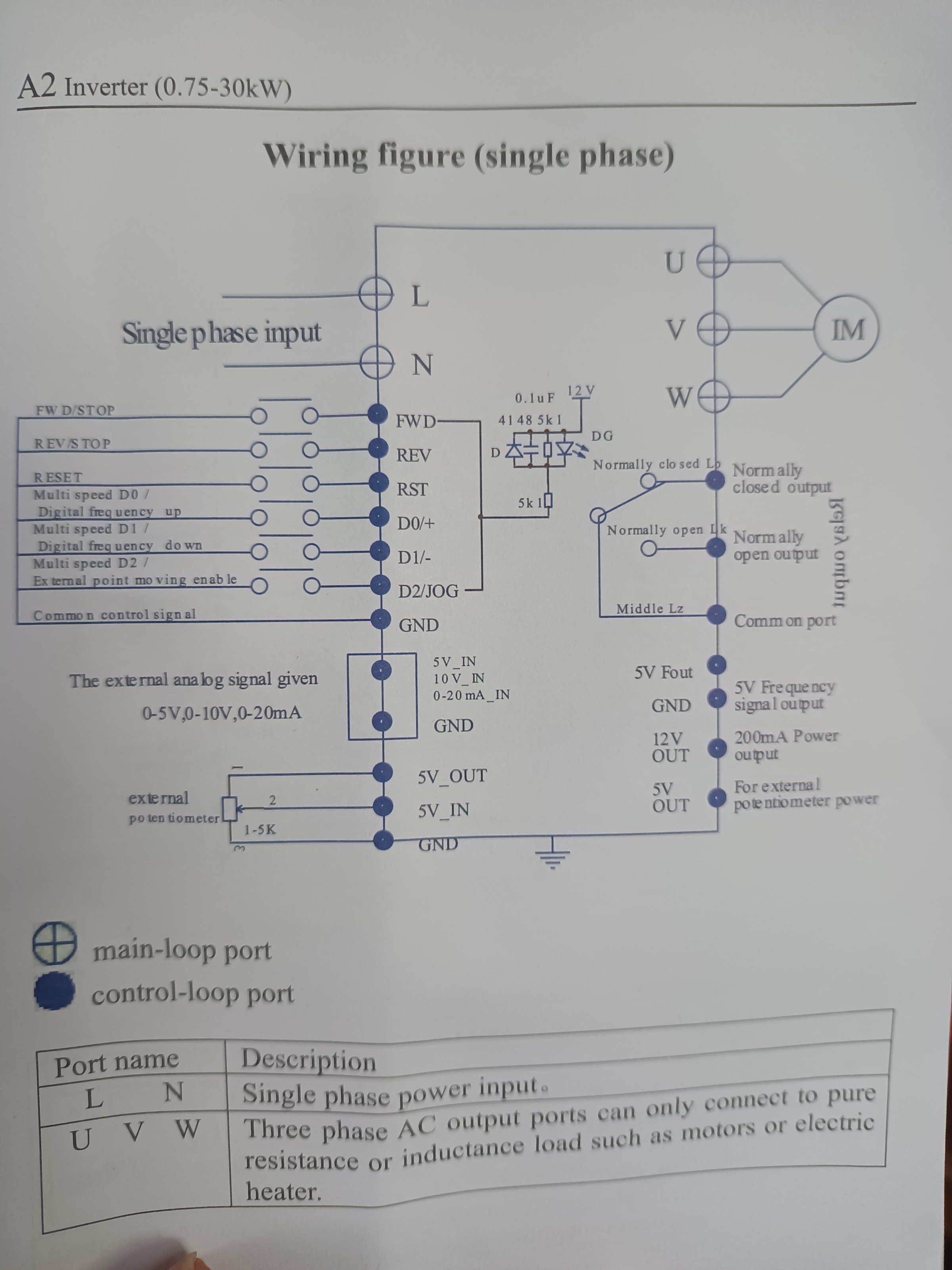

27 Feb 2023 10:07 #265491
by Drillbit
Replied by Drillbit on topic Linux CNC - Mesa Card 7i96s with iHSV57-XX Servo Motor
- Posts: 18080
- Thank you received: 5316
27 Feb 2023 16:22 #265507
Replied by PCW on topic Linux CNC - Mesa Card 7i96s with iHSV57-XX Servo Motor

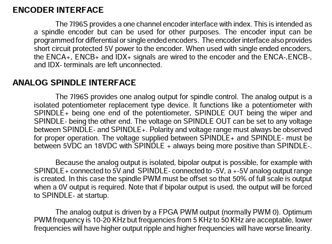

Yes, the 7I96S analog spindle output is designed for potentiometer replacement:
7I96S SPINDLE- --> GND
7I96S SPINDLE OUT --> 5V_IN
7I96S SPINDLE+ --> --5V_OUT
