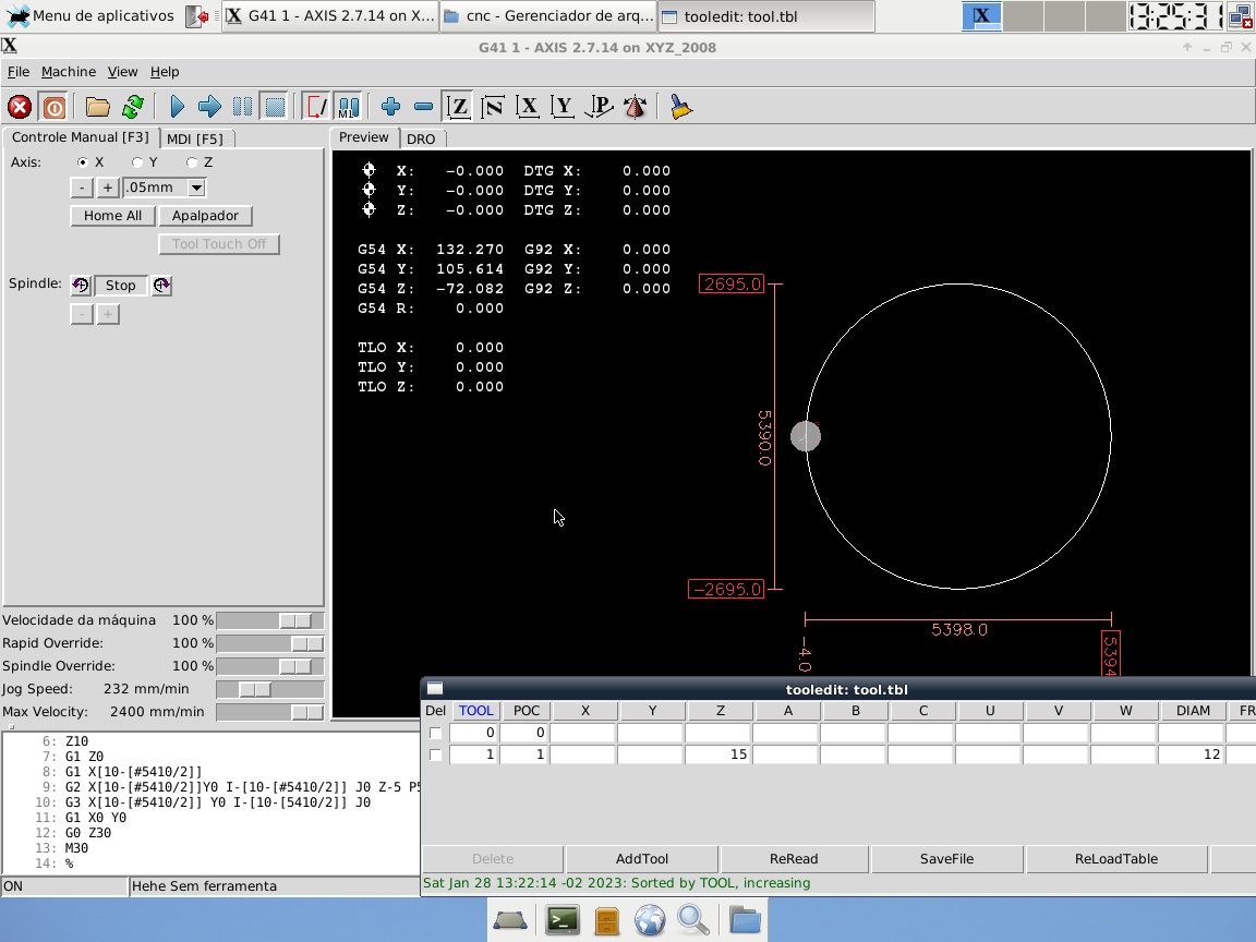

This way you can use tooltable and compensate wear, without G41/G42
#5410 is diameter of loaded tool.
Just remembered G64. If there is not something like 'G64 P.005' , it may give unwanted results

I tested this program, but the diameter was huge..
I changed the cutter from 12mm to 10mm, the tool diameter compensation worked..

If you try this with 'sem ferramenta' , but #5410 is only usable with loaded tool. I have a few parametric routines built this way and it works.
I would change following in the Macro and try:
- G94 is missing (feed per minute)
- N105WHILE[#4LE#2]DO1 to o105 WHILE[#4 LE #2]
- N205END1 to o105 ENDWHILE
- N220G53G0Z0H0M5 to N220 G53 G0 Z0 G49 M5
- Normally #1 to #30 are used and overwritten in subroutines, as they are global. I would name numbered parameters outside this range.
