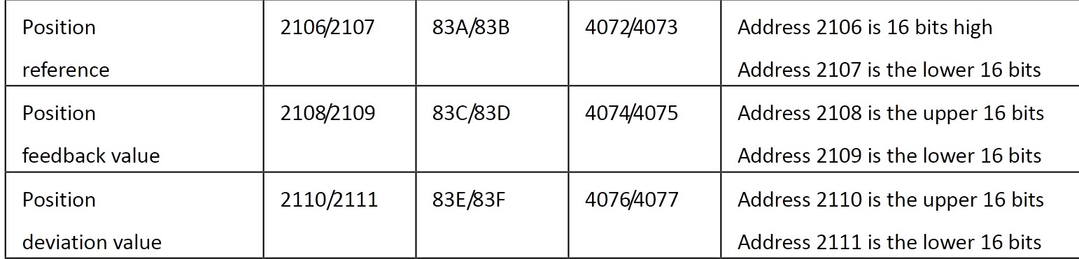

In the manual I found the addresses but how should I interpret them.
Is address 2125 the absolute encoder address of lower 16bits multi-turn data and address 2126 the absolute encoder address of higher 16bits one-revolution data?
I also found a parameter P00-29. Does this parameter change addresses 2125 and 2126 in low or high?
As i mentioned in the previous post i need three addresses. In the manual i found some other 16 bit addresses.
Here it refers to upper and lower bit addresses. I know nothing about modbus and 16 bit addresses but are these relevant.

How can you tell if these 16 bit addresses are high or low because SZGH asks for a High and low 16 bit address?
When do you need or use, in general, a high or low 16 bit address?
