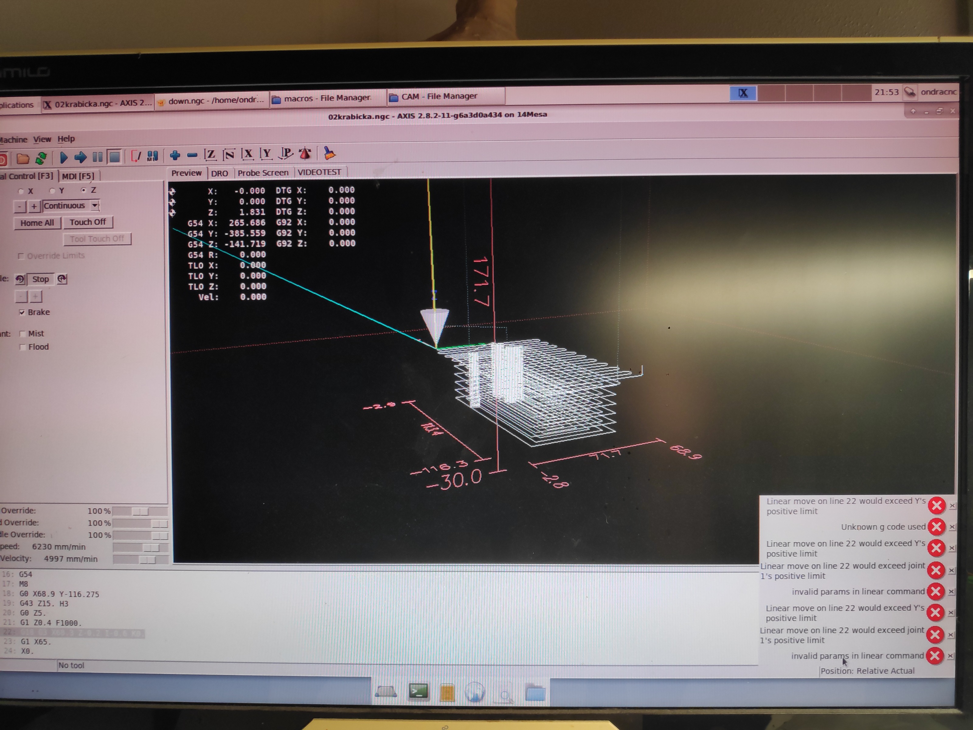

Hello,
on my testing PC with connected motors I wanted to run the script, because I want to learn how to use probe screen, which I want to then use on my cnc machine.
I wanted to run just one program, but Iam getting an error which you can see - the part is in the middle of the machine as you can see, there is no place where it can go - I was running exactly the same script even on my cnc machine and I milled some parts, this script is just modifed with some chamfers - so there is another milling bit.
ONLY ERRORS IAM GETTING ( I was trying to fix that ) :
Linear move on line 22 would exceed Ys positive limit
Linear move on line 22 would exceed joint 1s positive limit
invalid params in linear command

28 Feb 2023 21:59 #265621
Replied by PCW on topic Why there is this error
What is the gcode on line 22?

There is just G18 G3 X68.3 Z-0.2 I-0.6 K0.
03 Mar 2023 00:33 #265752
Replied by andypugh on topic Why there is this error
Is the preview shown as being entirely within the red dotted bounding box? (You might need to look from several angles)

I solved this - in added variable from INI section named [CHANGE_POSITION] (# Absolute coordinates of the tool change point) there is Z position - it was out of my machine limits.
