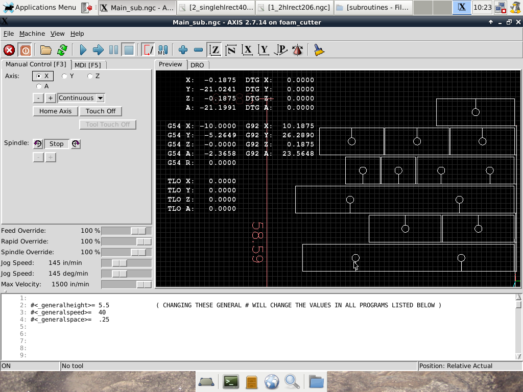

I'd like to give the VCP panel a shot for a couple shapes I have in mind, I guess there is documentation on that in the GUI index?
I'll try and explain what I know people are doing. Not with Linux, but I don't see why not.
My business is manufacturing SIPs. My EPS cutlist will contain 30 different shapes. Although all the shapes are rectangular, I have 30 different widths to cut out with varying numbers of each. The foam blocks come in 3'x4'xbetween 8'&16'. The way I was taught by the guy that sold the foam cutter is.
Plan the block, draw pieces in 2D with spaces between exactly as they are going to be in the block, essentially nesting them. All the pieces have an 1-1/2 wire chase through the center. 2 if it's over 24". Those need to be drawn in there as well making sure that the path from the uotside edge,in to the chase is more then your wire kerf is set to. Export that as a DXF and load into DeskCNC where the post hangs out, tell deskcnc in which order you want those 12 pieces in the block cut, ( because it has to cut from the top down, and unlike a machine witha vertical axis, it can't just lift of and go cut something else) and load that Gcode file into Linux.
Works, but it's slow and I don't like it. Mostly because I know of a better way.
The guy I know with the Frogwire has the same programs written that I do (albeit in it's language). He has 1 main program where all his other programs that he might need to finish the block are declared at the top of the program and through a series of WHILES and DOWHILES and whatever else he can plan the block in minutes, load that file and start cutting the whole block start to finish.
Done.
My problem is I don't know where to begin with calling up a different program from the main one. I've seen the example in the GUI guide, and what andypugh wrote, but something is not clicking.
And then I saw in the GUI guide, a mention of declaring the filepaths for subs in the Hal file. So I think maybe I need to spend some quality trial and error time.
Unless someone has some ideas.
Any help is appreciated

18 Mar 2023 21:10 #267032
by MaHa
Replied by MaHa on topic calling subroutines
I made this example with subroutines. You can define which routine and the order
FULL FILE AS ATTACHMENT !
(************ ROUTINES 1-30 PLACED HERE FIRST, NAMED BY IT'S NUMBER)
;******************************** 1 ****************************
o<1> sub
( THIS WILL MAKE 1 RECTANGLE WITH 2x1.5" HOLES )
(VARIABLES #1 - #5 FROM CALLING ROUTINE)
#<1width> = #1 ( ENTER WIDTH OF RECTANGLE #1 )
#<1height> = #2 ( ENTER HEIGHT OF RECTANGLE #1 )
#<startpoint> = #3 ( absolute Y&A point where wire will start cutting )
#<wire> = #4 ( ENTER OF WIRE CUT )
#<lspace> = #5 ( ENTER LATERAL WIRE MOVE BEFORE CUT )
( DON'T MODIFY ANY NUMBERS BELOW THIS LINE )
G90
G4 P2
G1 X 1.75 Z 1.75 f100
G1 Y #<startpoint> A #<startpoint>
G1 X 0 Z 0 f35
G91
G1 Y- [#<1height>+#<wire>] A- [#<1height>+#<wire>]
G1 X [#<1width>+#<wire>] Z [#<1width>+#<wire>]
G90
G1 X 0.25 Z 0.25
o<1> endsub

#101=2
#102=3
#103=1
#100=1
o100 while #[100 + #100] GE 1] AND [#[100 + #100] LE 30
o#[100 + #100] call
#100= [#100 + 1]
o100 endwhile
M2

17 Apr 2023 13:43 #269302
by foam man
Hi guys
I just wanted to share how my subroutine programs work out in the end
the way it works, I look at the cut list, figure out which pieces you need out of this block, go into main_sub and remove the slash in front of the programs you will need, making sure all the rest have a slash so that linux will not read them. For what I do, the height will remain the same for all the pieces per project so using the generalheight global variable works. Otherwise, make sure my widths all match with my cutlist and cut the whole block. It takes roughly 2 min to plan a block and nest it, versus drawing up each block individually and creating gcode through a post
thanks for all your help
Replied by foam man on topic calling subroutines
Hi guys
