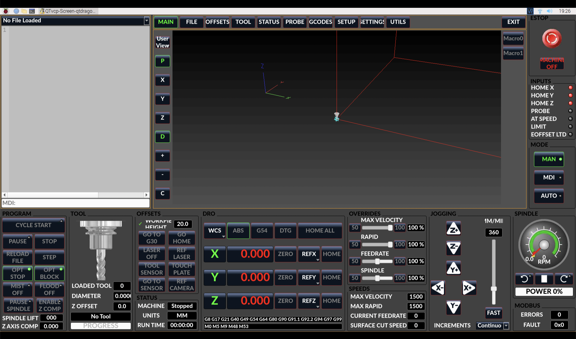

QTDragon_HD Pi4 font size was created by chernogorsky

Replied by cmorley on topic QTDragon_HD Pi4 font size
probably the style sheet.
press F12 to see the style sheet editor

Replied by chernogorsky on topic QTDragon_HD Pi4 font size
I saw it, but dont understood what to change there ?
Any points to start from ?
linuxcnc.org/docs/2.9/html/gui/qtdragon.html#_stylesheets
gives a hint. Look for 'font:'
'pt' stands for the size
this is size 25 style lato heavy:
font: 25pt "Lato Heavy";
Check the whole style,
the only huge font (20pt) is
DROLabel,
QLabel#label_axis_x,
QLabel#label_axis_y,
QLabel#label_axis_z,
QLabel#label_axis_a
rest is 10 an below
for 1980x1080 10 should be rathe small (
So I think its more to pi4 itself than qtdragon, but I cant figure that owt
DROLabel,
QLabel#label_axis_a
rest is 10 an below
Have found that if I add
export QT_SCALE_FACTOR=1
or QT_SCALE_FACTOR=1 before running lcnc it looks as it should be
have check defaults
have check defaults
Excellent. I have not heard of that setting. Do you have a link with info?
